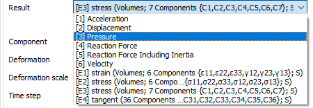

These are the relevant results options for the surface colour map plot.
Screenshot 2024-12-18 230417.png (12.27 KiB) Viewed 3333 times

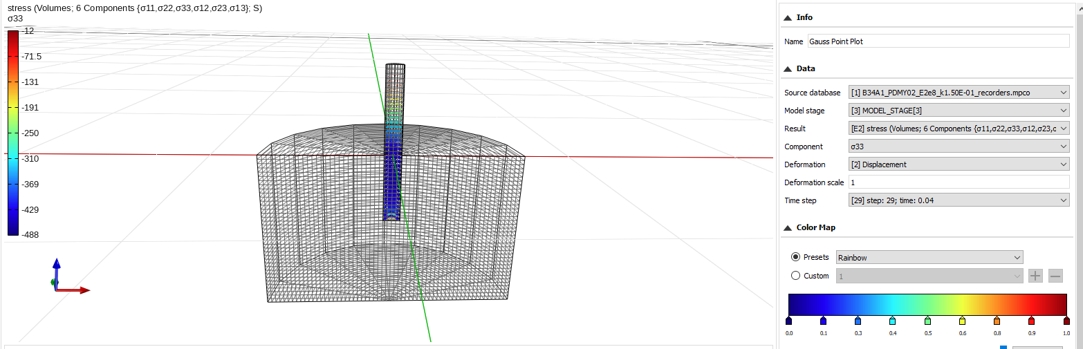

However, when I switch to the Gauss point plot to select the Gauss points for the relevant chart, I cannot see any Gauss points in the soil elements. The only Gauss points visible are for the stresses in the pile.
Screenshot 2024-12-18 225838.png (196.97 KiB) Viewed 3333 times
This is the relevant results options for the Gaussian point plot.
Screenshot 2024-12-18 230227.png (9.07 KiB) Viewed 3333 times

You have 2 stress results, the second one (the one with 7 components) refers to the PDMY2 material which puts an extra variable (the 7th one) at the end of the stress tensor components

When I attempted to use the Gauss point plot to select the relevant Gauss points for plotting the appropriate graphs, I found that none of the Gauss points associated with the soil were displayed in the plot. The only Gauss point that had stress data in the Gauss point plot originated from the pile material, which is linear elastic.
The results of the second stress results (the one with seven components) can only be viewed on the surface colour plot and not in the Gauss point plot. Is there any way to visualize these results in the form of the Gauss point plot instead of the surface colour plot?

Unfortunately this happens when SSPBrick elements (with 1 integration point) is used in combination with PDMY materials (that do not write enough information in the output as all other materials/elements).
We will try to modify the code in OpenSees for those materials/elements.
In the meantime the solution is to create 2 recorders, one for only the geometries with SSP elements + PDMY materials and the other with the remaining model.
You can do it using region command and put them in the MPCO recorder
