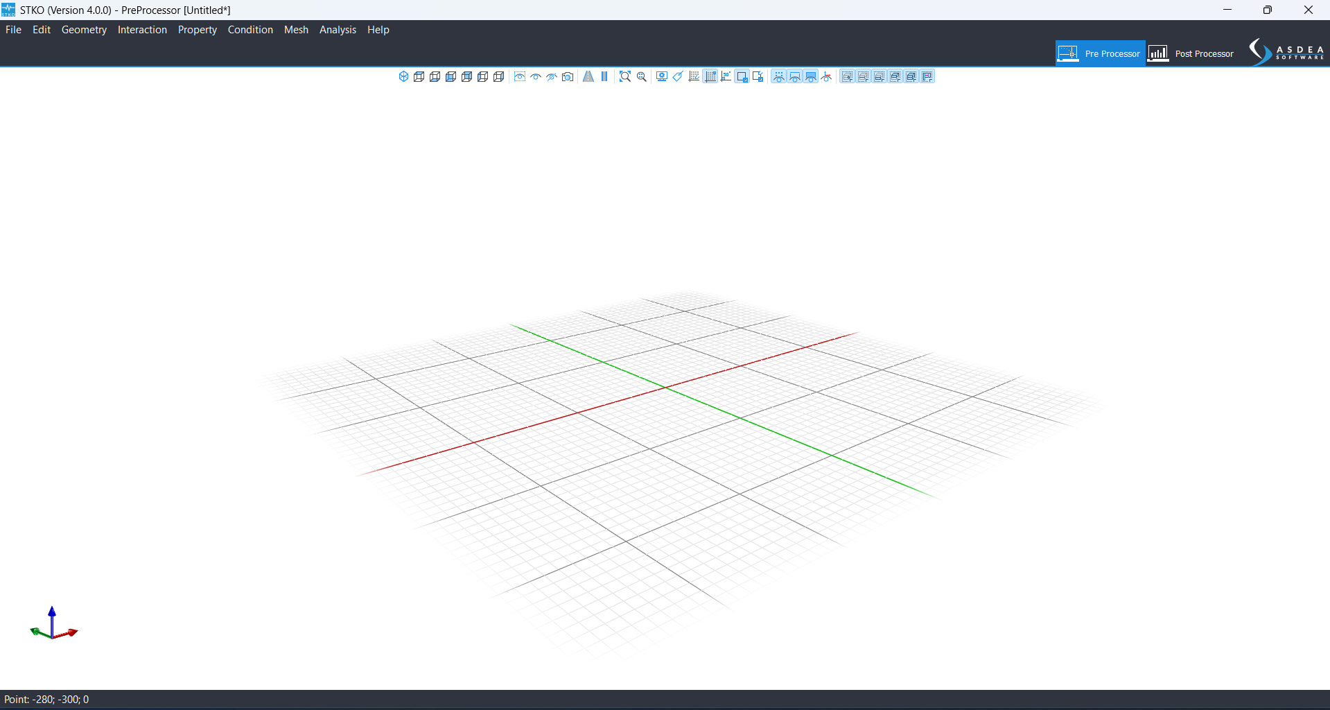

Dear team.
To take an screenshot of a model, I closed all the sub-windows of the Pre Processor and now I don't know how to fix it.
Screenshot of Pre Processor
Captura de pantalla 2025-02-26 140108.png (294.05 KiB) Viewed 2708 times
I tried uninstalling STKO, but didn't worked.
I would deeply appretiate your help on this.

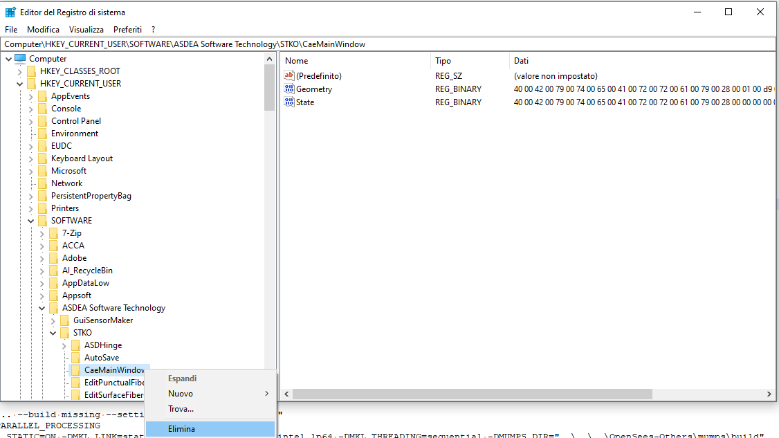

Unfortunately, if you close all the windows, you will not have space for right-click and show them again.
However, you can restore it using reg-edit, and clear the setting for the CaeWindow (pre processor):

Post by AlbertoH » Tue Mar 18, 2025 3:40 pm
Solved ! Thank you so much !
