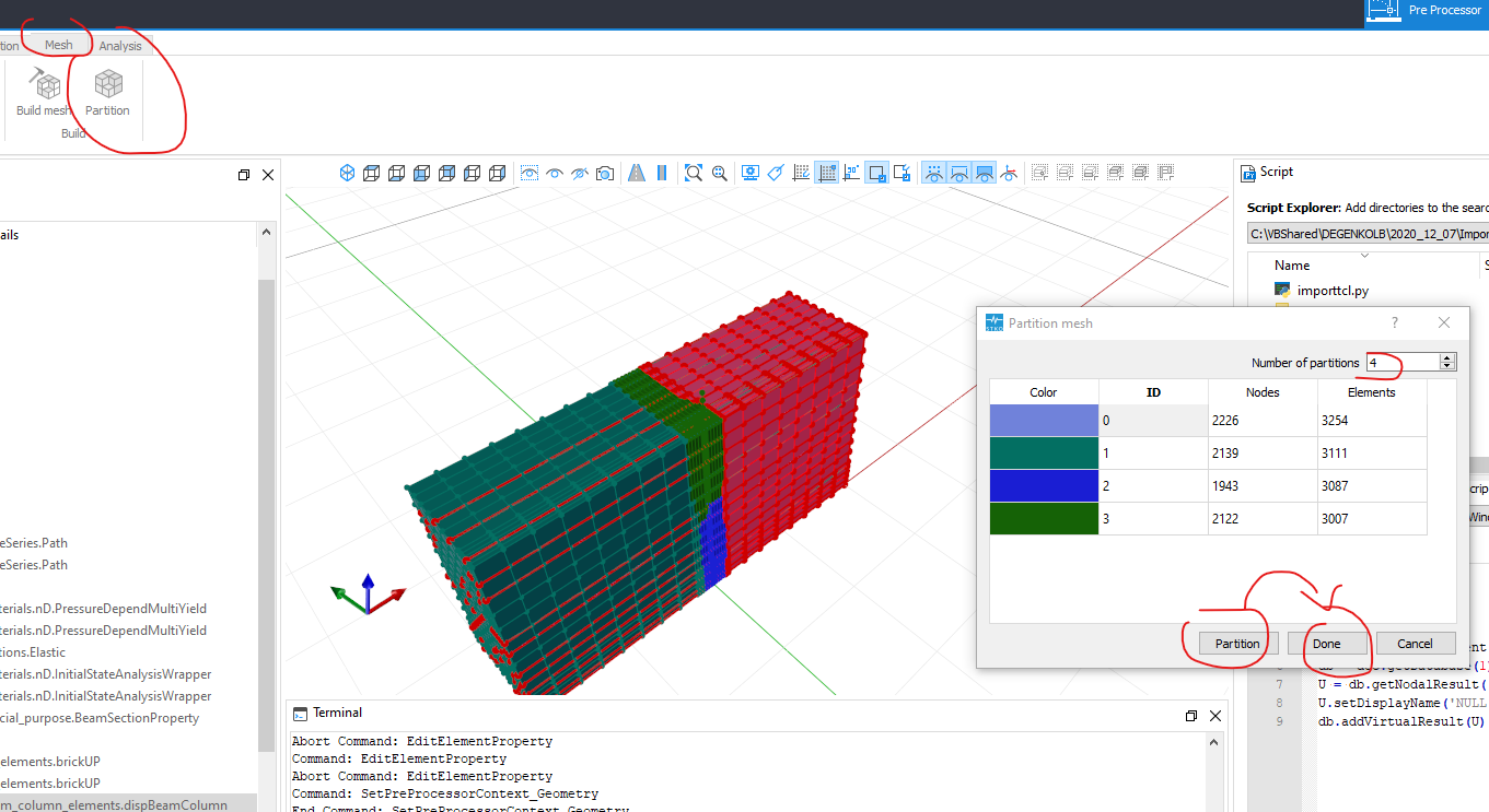

Some error appear when I was trying to run soil-pile interaction seismic loading .scd model using openseesmp.
I cannot find anything improper in the model, if possible, could please help me check what is wrong with the model?

That error means that you forgot to partition your model.
Partition your mesh in as many processes as you want:

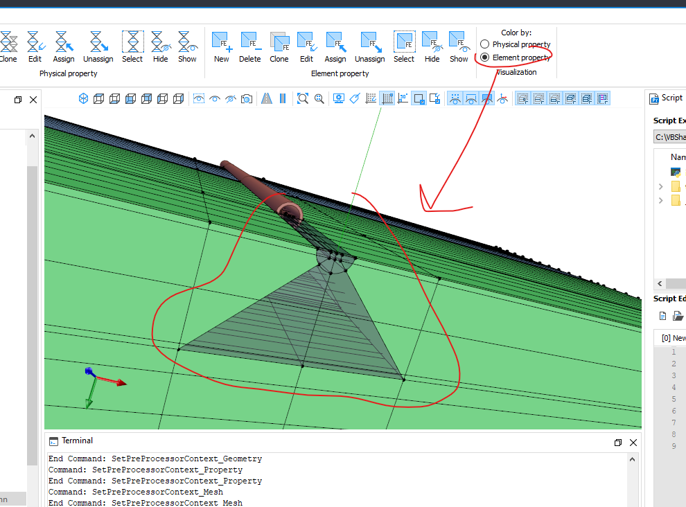

Note that you forgot to assign element properties to some sub-solids of your soil geometry, thus your model will be singular:
