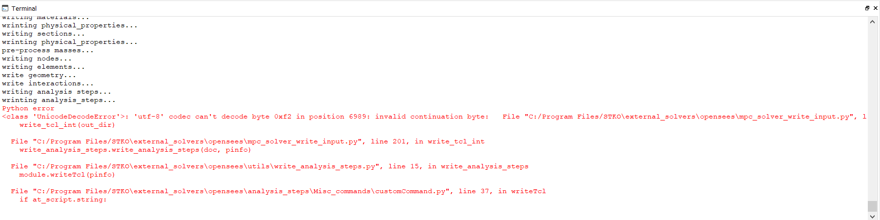

I have used custom command to run a pushover analysis but STKO give me this error:
How can I fix it? thx

Hi, that error means that in the TCL script you put in the customCommand, you inserted some non ASCII character, like characters with accents or other special unicode characters... probably in the comments.
Please post the TCL script here and I will have a look

OK yes. That's the problem. I have modified the accents and the analysis run. Thx much
