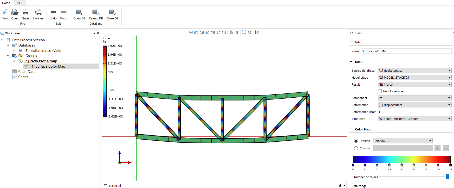

I have a problem with an output. I have modelled the structure in photo but I don't understand why the axial force is wrong. It is as if the element was divided into 4 sub-elements (mesh edge by division = 4) and each of them was loaded with a different force. And a non-constant butterfly axial diagram comes out. Can you help me?

The results are actually right. You see, in each element, the same axial force but with opposite sign at the 2 end nodes. This is because you are visualizing the "force" result. "force" contains the element forces at nodes in global coordinates.
What you want to visualize is either 1) "basicForce" or 2) "section.force".
Be aware however that in OpenSEES "basicForce" is an output given by almost all beam elements in 2D, but in 3D only by the ElasticBeam!
While "section.force" works with all beam elements that have sections, both in 2D and 3D. This means that only the ElasticBeam does not support it.
If you still have problems send us your .SCD file and we will correct it for you

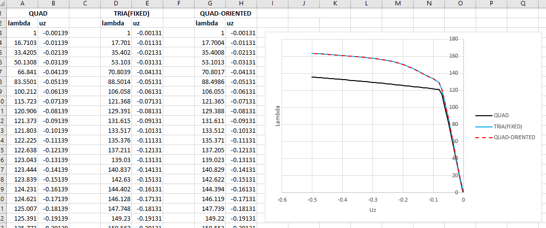

mismatch fibers.png (49.18 KiB) Viewed 8070 times

I have rotated QUAD section and I have fixed TRIA section in STKO. Moreover I have modelled the same structure in SeismoStruct for compare results. I have also changed the trasformation from Linear to P-DELTA. But the results don't perfect match:
I have sent again the attachment in PM. Thanks.

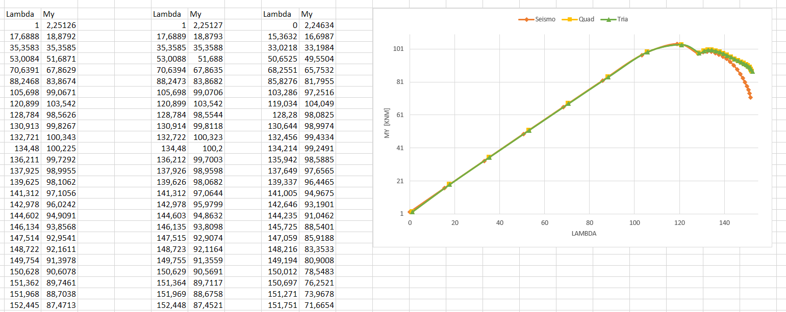

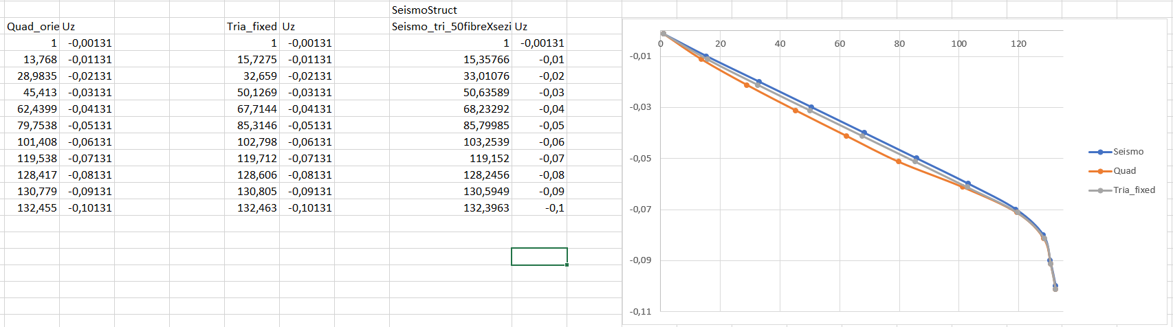

Posted: Mon Nov 25, 2019 10:07 am
by GianmarcoManzo
The results between triangular fiber and quad fiber modeling are now the same. But unfortunately they are not coincident in the non-linear phase with seismostruct. I attach a photo
