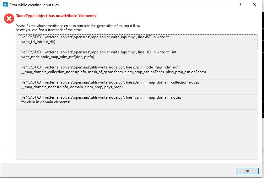

Dear STKO team ,
I would like to kindly ask you to check where the mistake is in the attached model. It is just a simple collection of some plates assembled together. The error message says that there are some geometries without an element type assigned to them. However, I have checked and assigned the element types to the geometries twice, but I was not able to identify which geometries are left without element assignments.
Also, is there a way to identify which geometries are missing element type assignments?

This error means that some sub-geometries in your model has not been meshed (due to a very imprecise geometry):
