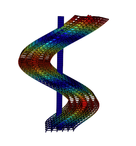

Looking at the mode shapes, you can see that there is a core column that is not connected:

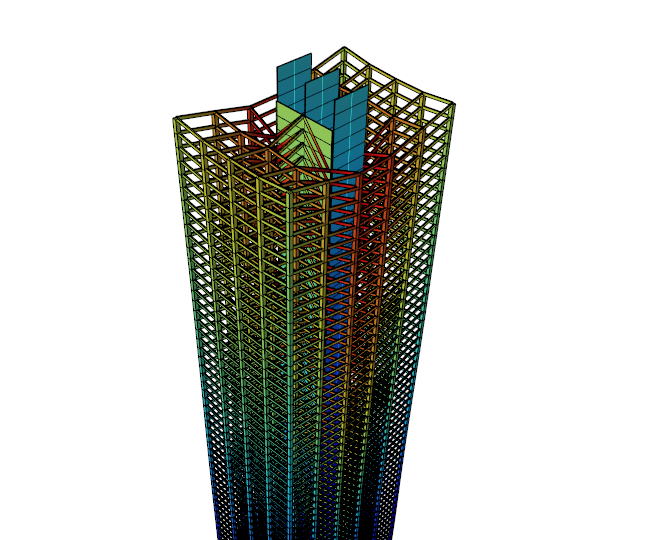

However I think there is still some mistakes. Looking at the first steps, from the displacements of the dynamic analysis you can see that also the other core walls have a strange displacement, and I noticed that you did not connected them to the beams of the frame (they are only attached with the diaphragm in the X-Y plane, but not in the Z DOFs), I don't know if this is meant to be like this or not. Double check your model
