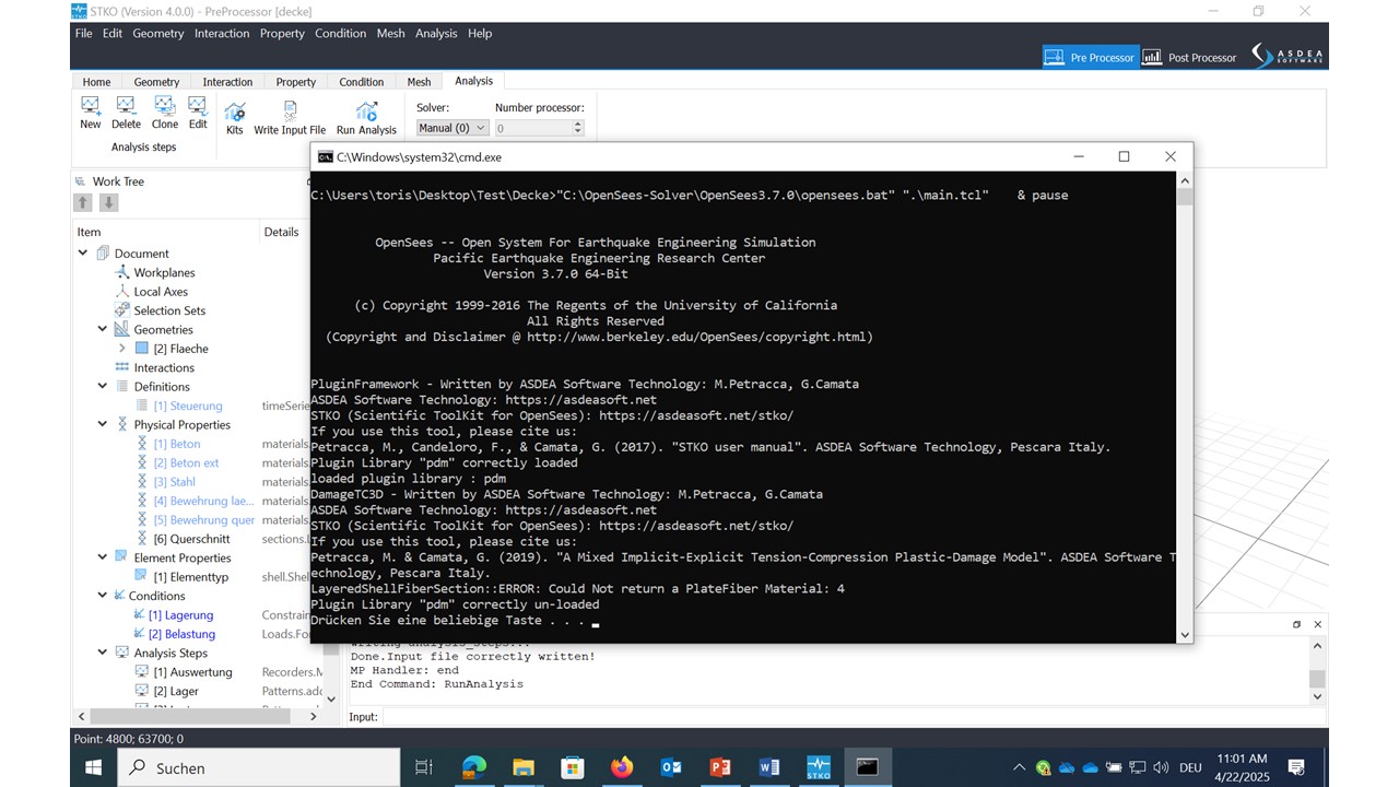

I tried to run a file and received an error message saying that the pdm.dll file could not be found. However, the file is located in the folder C:\OpenSees-Solver\OpenSees3.7.0\plugins. Does anyone know what this problem is?
Posts: 3068
Re: Cannot find pdm.dll
Post by STKO Team » Tue Apr 22, 2025 7:39 am
If the installation of the OpenSees-Solvers is correct, and you are running it one of the batch files (opensees.bat, openseesp.bat or openseesmp.bat) OpenSees should find that DLL

Post by HBC_FEM » Tue Apr 22, 2025 9:04 am
thanks, it seems to work.
But now i have another error message (see attachment).
You may help one more time.
regards.

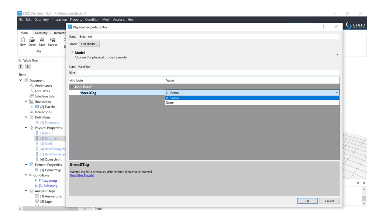

Post by STKO Team » Wed Apr 23, 2025 8:26 am
Put the DamageTC3D material into a PlateFiber ND material wrapper, and use that in the layered section
HBC_FEM
Posts: 6
Joined: Tue Apr 15, 2025 5:47 am
Post by HBC_FEM » Wed Apr 23, 2025 9:25 am
that was already done.
Beton material was the TC3D and Beton ext was the plate fiber material.
But it seems that there is a problem with the rebar fiber. I am not sure.

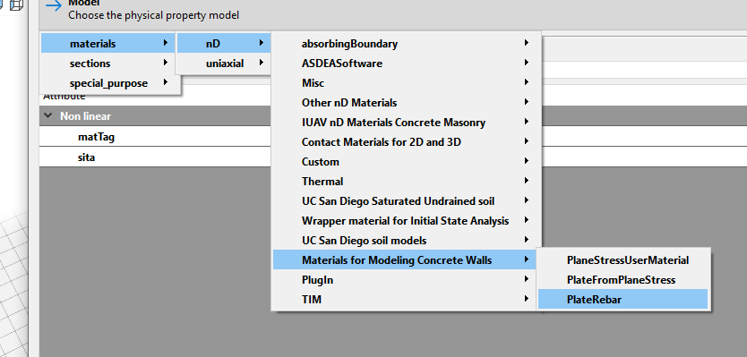

Posts: 3068
Post by STKO Team » Mon Apr 28, 2025 8:15 am
You have to use PlateRebar for shells, not PlaneStressRebars (which is for 2D plane-stress analysis):
Then you will find an error about the compressive fracture energy being too small...
