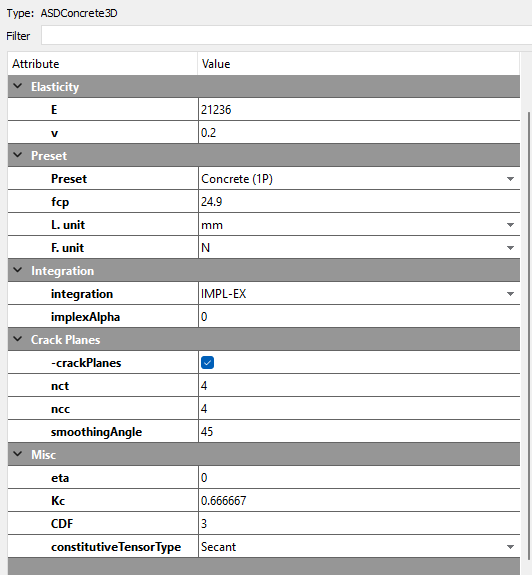

I am recreating the column studied by Mo & Wang (2002). For the analysis, I am using Steel02 for the reinforcing steel and ASDConcrete3D for the concrete.
After several iterations, I have noticed that the material behavior is highly sensitive to the Cross-Damage Factor (CDF) parameter.

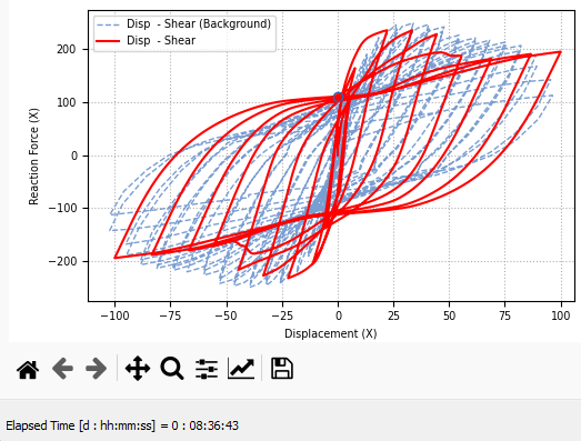

Monotonic loading: With CDF = 3, I obtain fairly good results.
Cyclic loading: Using the same value (CDF = 3), I observe a rapid degradation of strength and stiffness, as well as smoothed "drops" in the response that do not seem to have a physical meaning .

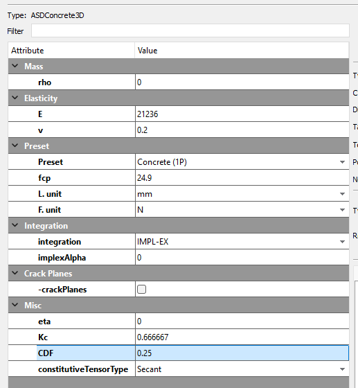

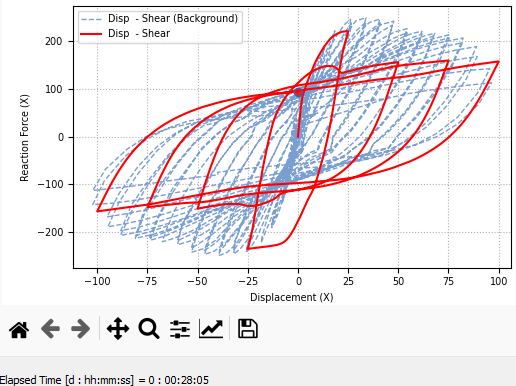

Cyclic loading with CDF = 0.25: The results improve, but I still cannot properly capture the pinching effect of the material or the degradation in the last loops.
I would appreciate any recommendations on the appropriate CDF value for this analysis and any suggestions on how to better capture the pinching effect without experiencing such rapid degradation.

Just a quick update on this post — the model was having issues due to the steel constitutive law being used. After switching to the HystereticSM model, the results were satisfactory.
Best regards!
