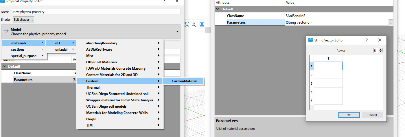

I am currently working on the dynamic response of piles in sand and need to use the SANISAND-MS model (nDMaterial SAniSandMS) developed by Liu et al. (2019). However, I have not found the nDmaterial command for this constitutive model in STKO. Is there a way to assign this material to a soil model?

We will implement it in STKO in the next versions.
In the meantime, when a material model is not directly available in STKO you can use the custom nDMaterial interface:
