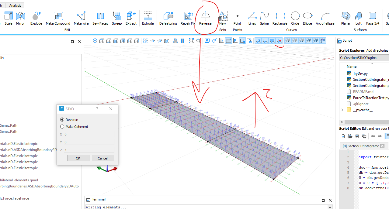

Can someone help me identify my error? Thank you, it's a 2D soil profile with 3 layers
Posted: Sun Dec 08, 2024 3:46 pm
by nathaliaodz4
https://drive.google.com/file/d/101BrCf ... sp=sharing
Re: Can someone help me identify my error? Thank you, it's a 2D soil profile with 3 layers
Posted: Mon Dec 09, 2024 2:49 pm
We already answered to another of your posts, the geometry is flipped.
In 2D the Z local axis should point towards the Z global axis
