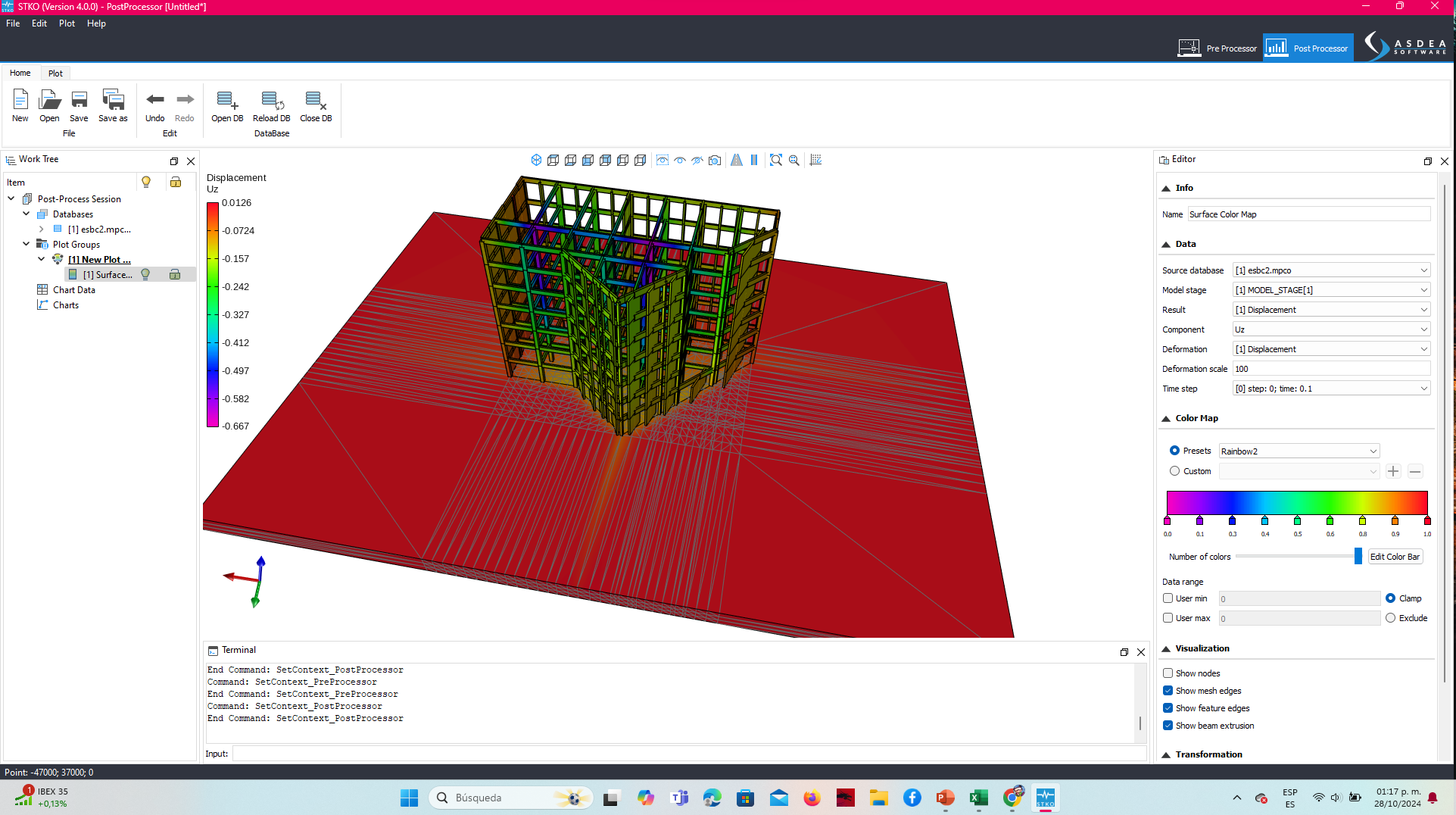

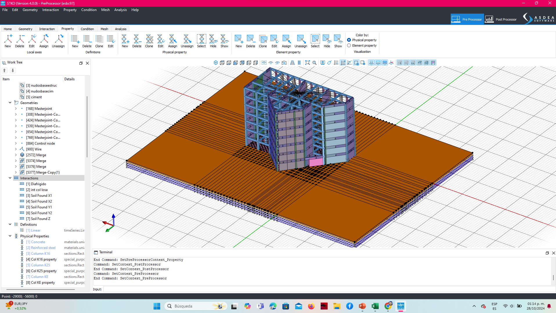

I modeled concrete walls as wide columns with rotated axes, as shown in the attached image from the preprocessor. After running the simulation, these wide columns appear rotated in the postprocessor (see the second attached image). I’m not sure why this is happening. While the gravitational results are correct, I'm concerned about potential issues with the seismic dynamic non-linear analysis. Can you help me understand what’s going on? Thanks in advance.

Post by STKO Team » Thu Nov 07, 2024 8:02 am
