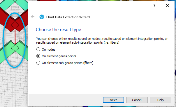

Dear STKO,
Thank you for the suggestion. I have tried to display the Two Node Link Element response following your suggestion, as illustrated in the attached figure.
However, no selected element result and no output can be plotted. Could you help me for that problem?
Regards

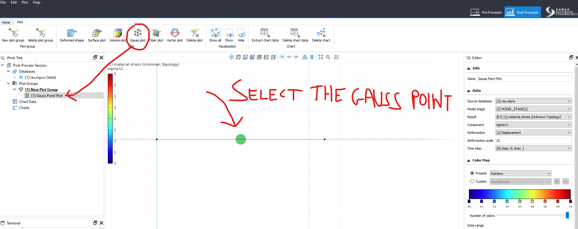

Dear user,
To extract data from Gauss Points you need to select the gauss point, thus first you need to create a GaussPlot. with that plot you will be able to select the gauss point you want.
Likewise, to extract data from fibers, you will need a fiber plot.
Surface plots can only be used to extract data from nodes.
Re: TwoNodeLink VS ZeroLength element
Posted: Fri Aug 21, 2020 12:34 pm
by angga-fajar
Dear STKO,
Thanks a lot for the guidance, that's work well.
