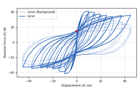

Hi, I am using truss element(steel bars) and stdbrick element ( concrete) to build a numerical model of reinforced concrete columns. I would like to ask how can I take "geometric nonlinearity" into account in this 3D model? below is my model, any suggestions would be greatly appreciated!
