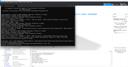

I have the following problem with the second model of the tutorial "STKO E-Learning Course - Modeling of a Reinforced Concrete Frame Structure (webinar in English)", it gives me an error regarding the value of the concrete "Error: the fracture energy (Gf = 0.03) is too small or the characteristic length of the element (lch = 100) is too large.
The minimum Gf to avoid constitutive rollback is 0.0283".

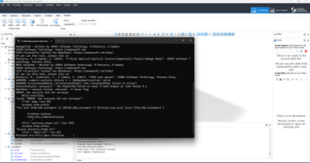

I have used different values for the meshing, reducing the lch and the gf, but the error persists. I also applied a solution that proposes deactivating the self-regulation, but convergence problems are obtained. I attach the file and the images of the errors. I hope you can help me.
