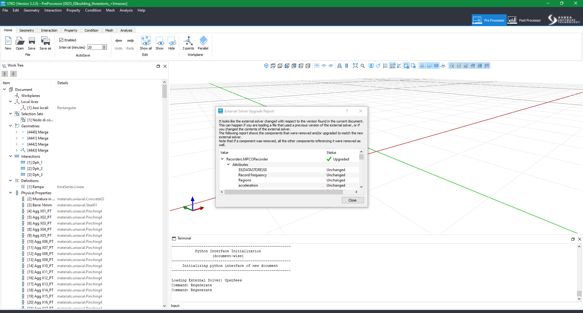

I downloaded all the models from the STKO Model Database, STKO only works with the first model 0001_fibercolumn, all the other models close STKO immediately.
I attached the screenshots of what happen when i open a SCD file
Please help me to find a solution or find what is the cause of this problem
