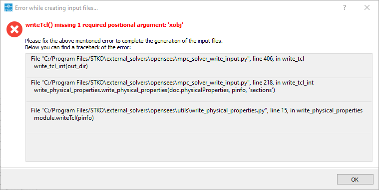

In all the models I have built it's going to continue appearing this error but I don't understand from which it could be caused.

It's probably because you are using sections->Iso2spring or sections->Uniaxial.
There was a small bug in the input (an extra unused argument)
It will be fixed in the next STKO release. In the meantime, unzip this folder (
sections_bugfix.zip
(2.6 KiB) Downloaded 174 times
) and copy/replace the 2 python files you will find inside, in the STKO installation folder:
C:\Program Files\STKO\external_solvers\opensees\physical_properties\sections

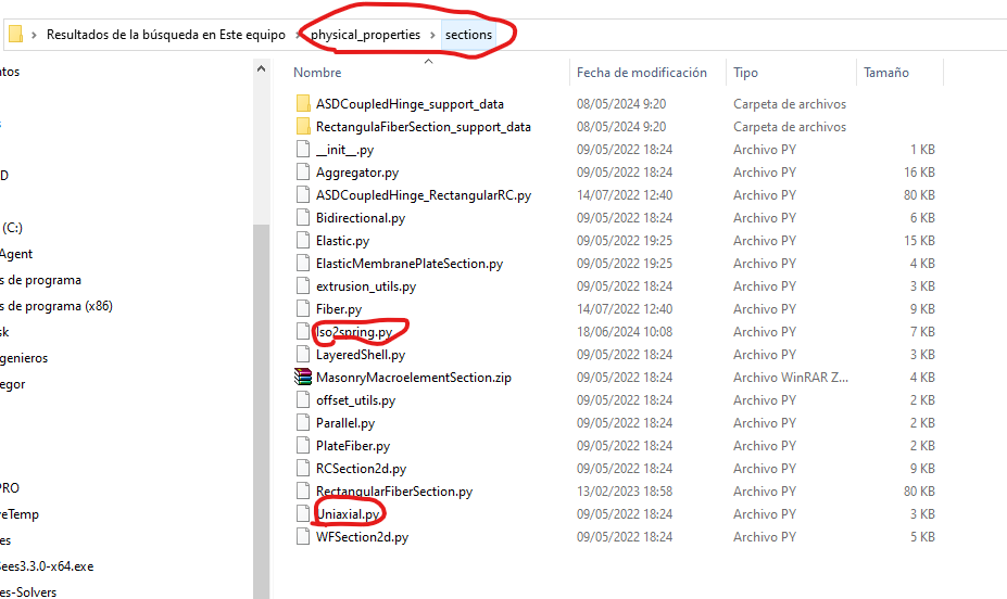

I tried to do what you recommended but I noticed that the files are already in the folder. I tried to replace them with files you have sent me but STKO's continuing to give me the same problem.
