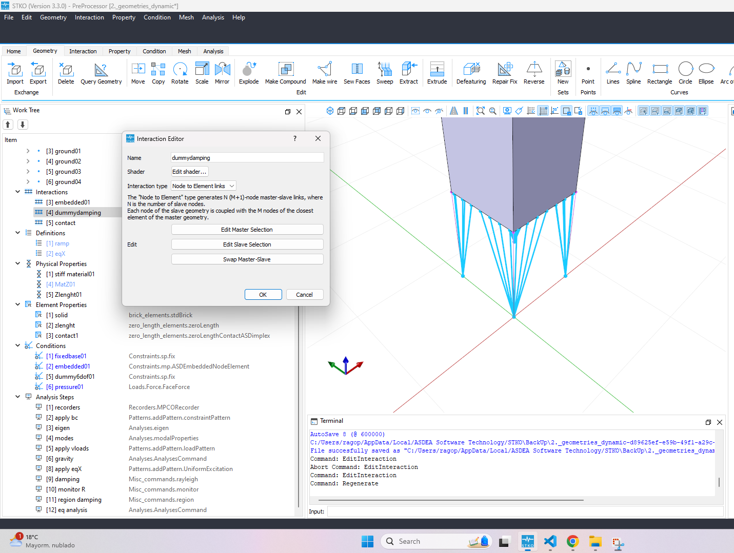

When I perform the analysis using a node-to-node link, there is no issue. However, since I do want to include “more than one point of rocking,” I want to model a surface. I checked your past webinars, and if I understand well, I can use a node-to-element link (please check the SS01.png attached).

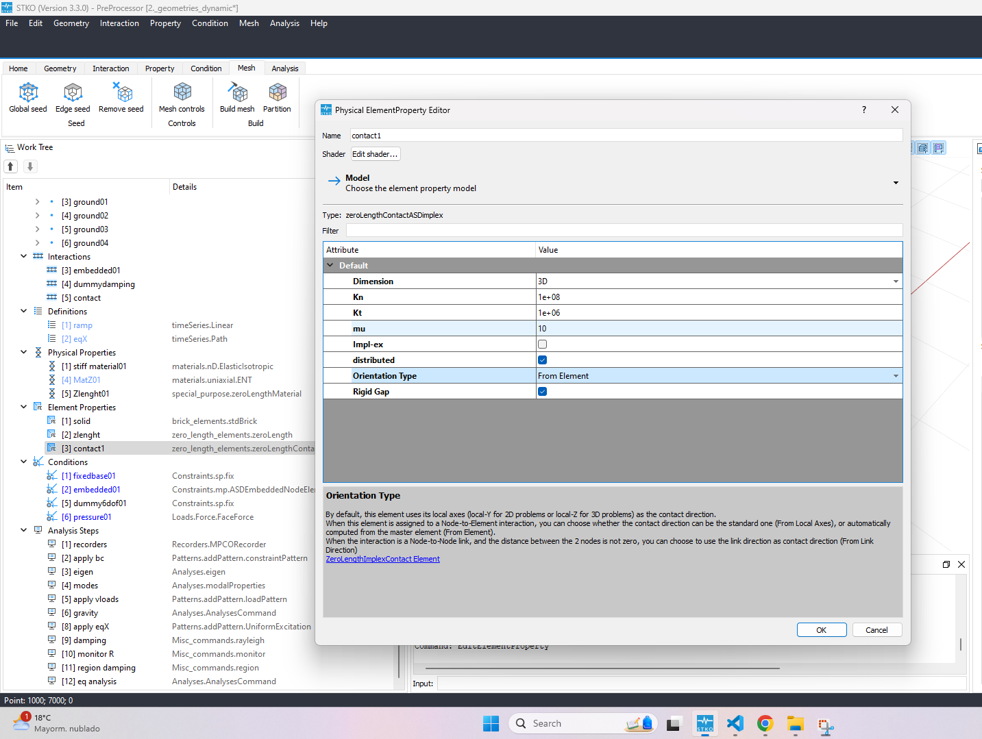

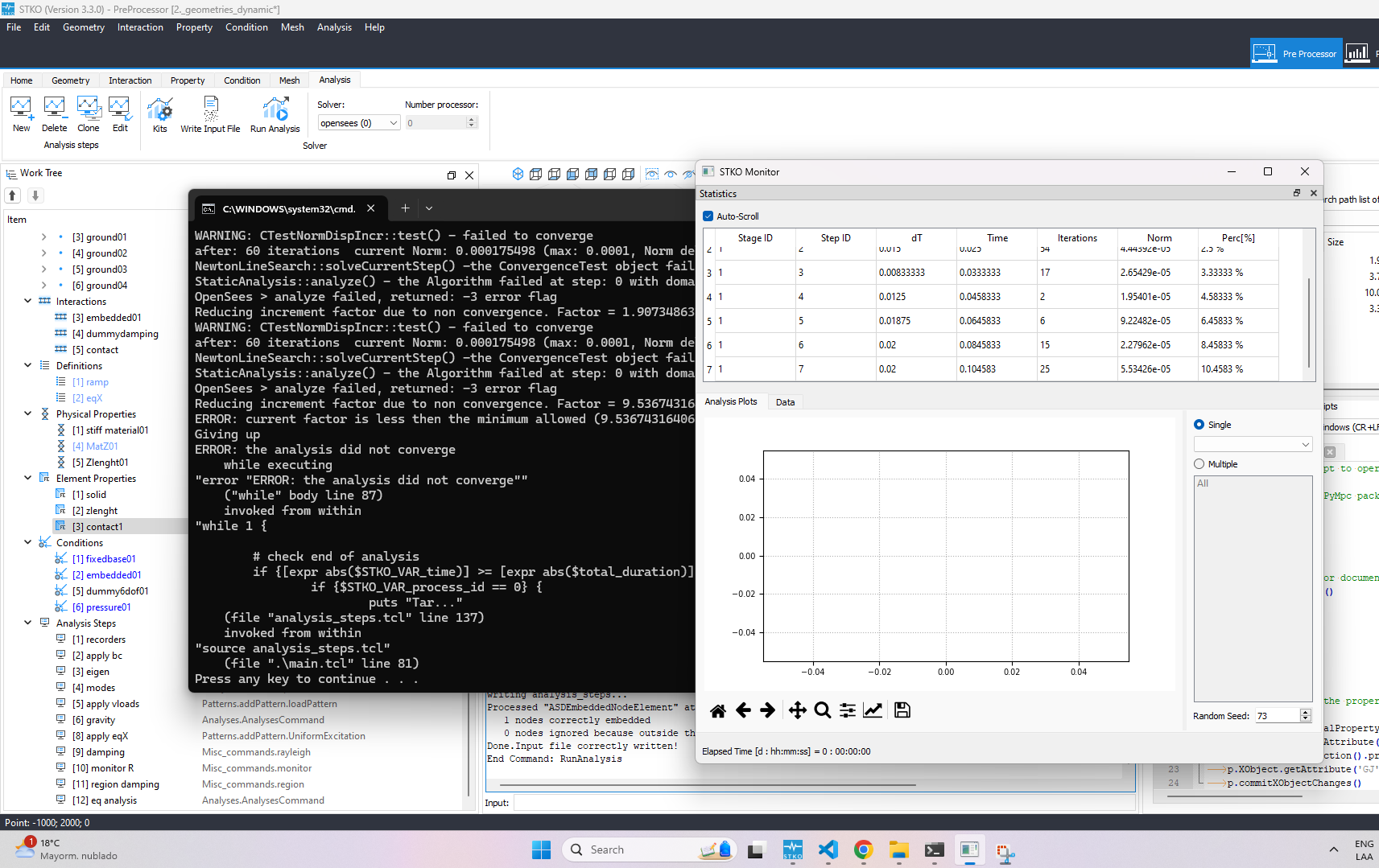

In addition, I have used contactASDimplex where the orientation type “from element” is selected (please see the ss SS02.png attached). Despite those steps, the analysis is not converging (see the SS03.png attached).

So you need to:
- Create a surface which is exactly equal to the bottom of the solid (you can use the Extract command)
- Make sure this new surface has the same mesh of the bottom of the solid
- This new surface does not need any ElementProperty: it will generate only nodes, not elements
- Fix this new surface in all translational DOFs
- Make a node-node interaction between this new surface (master) and the bottom of the solid (slave) (normal vector = +Z)
- Add a contact to it

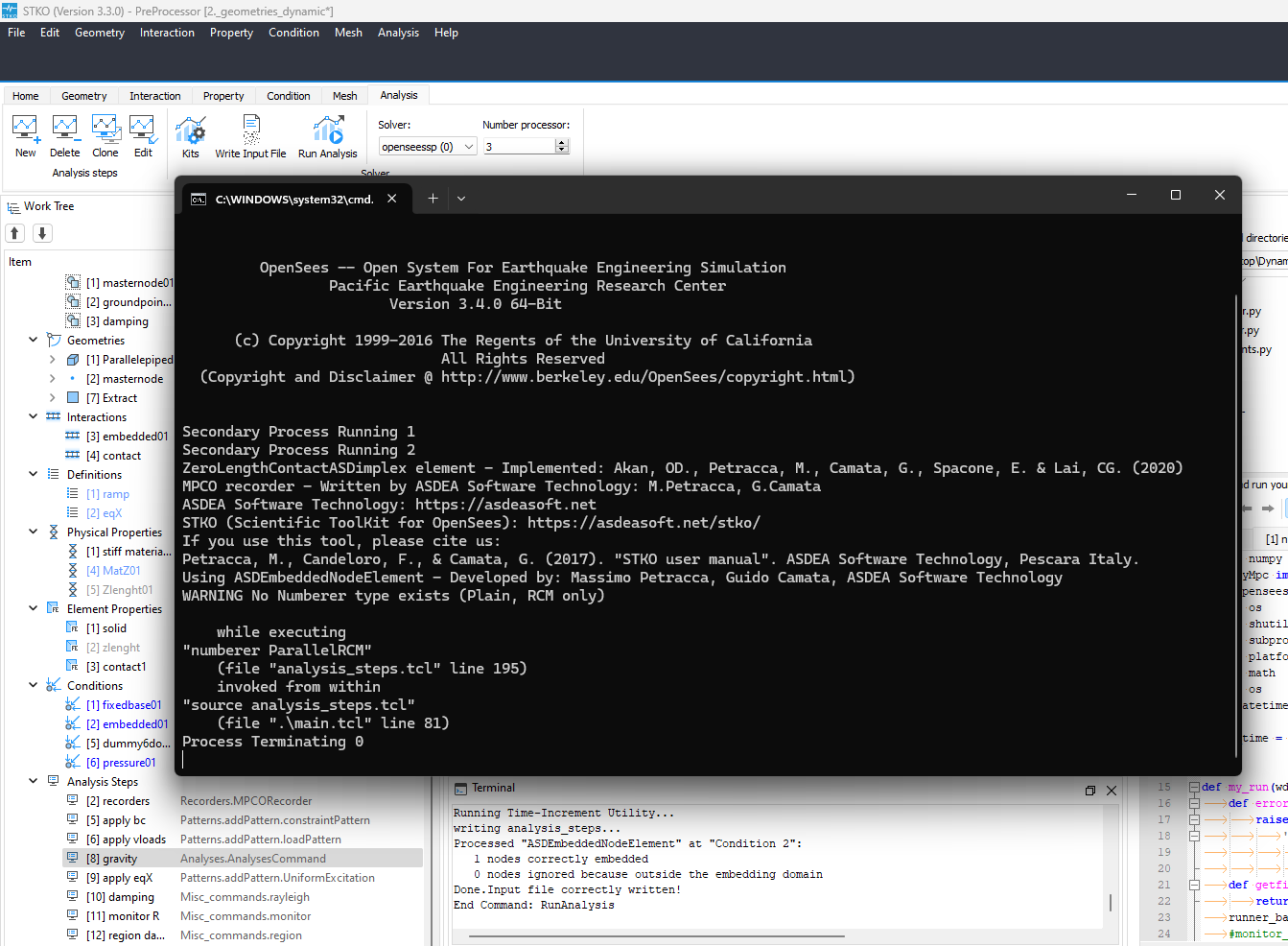

Thank you so much for this. I have been trying but it keeps the error. Could you please guide me?

It's because I made it partitioned for parallel computing. Use OpenSeesMP
