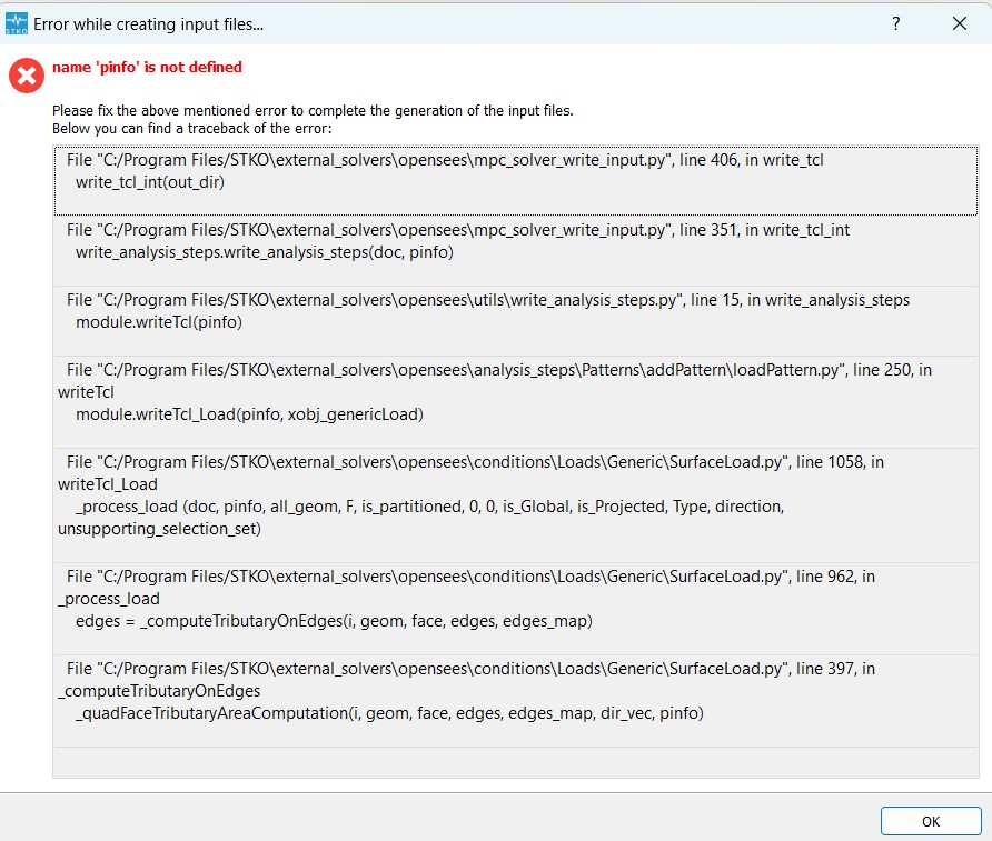

Dear stko team, I have the error in my model, it is not possible to generate input files, could you help me understand the reason? please

"Resolved: My mistake was assigning 'genereicLoad' to non-rectangular surfaces, so in this case, I opted to assign 'eleLoad' to beam-type elements."
