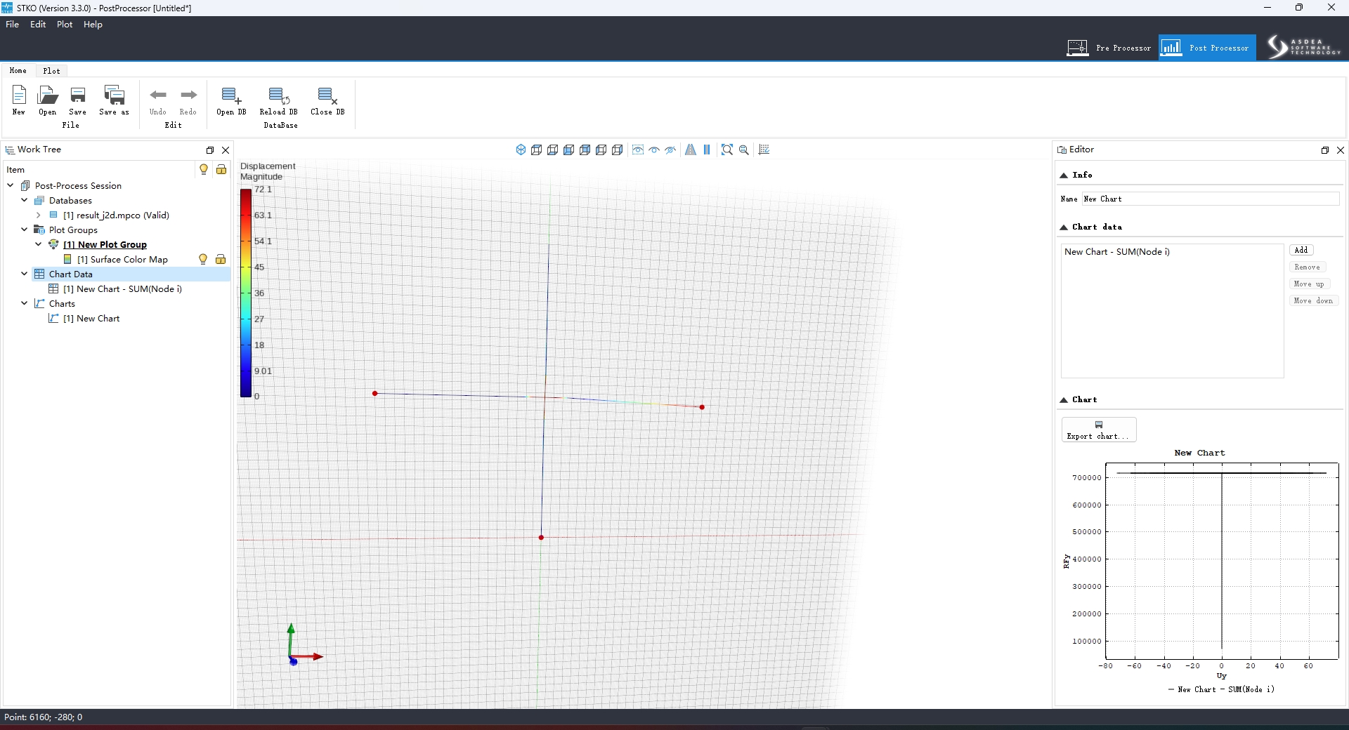

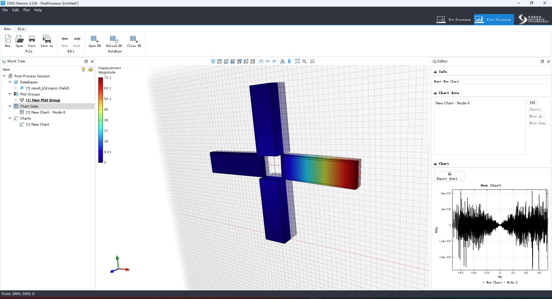

I have built a 2D joint model and performed a cyclic analysis, this model converges but I can't extract the correct hysteresis curve(RFy-Uy) at the loading point. I've double-checked the model but can't solve the problem. The curve I extracted and model is in the attachment. It is important to me, looking forward to your reply. Thank you.

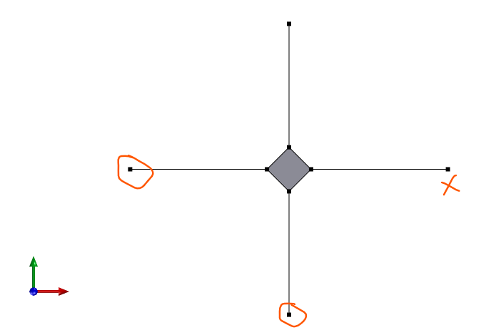

[1] Reaction force should extracted from the restrained nodes (fixed along Y DOFs), see the encircled nodes in the picture attached, this is where the reaction forces should be extracted and summed in your case.

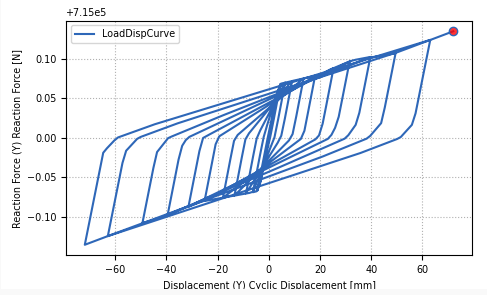

[2] In the model, I have added monitor custom command to track the force-disp in live.

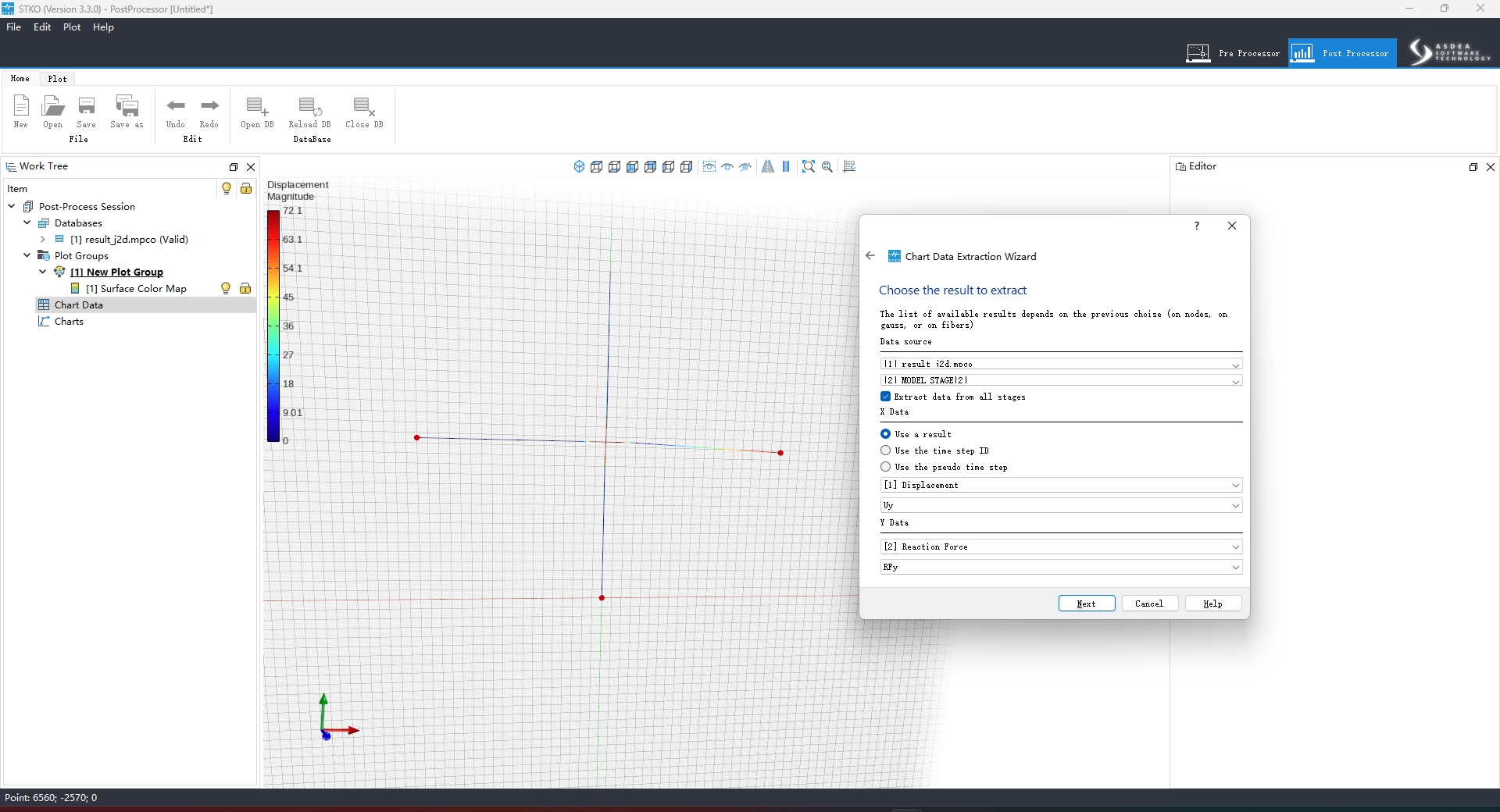

Thanks very much for your timely reply. I just calculated this model again and I saw the correct curve in the monitor, but in post processor, I extracted RFy-Uy curve as your reply and get wrong result as shown in the attachments.

Hi, the displacement and reactions come from different nodes, you cann't use the same plot to extract them. So extract them separately and use spreadsheet to plot the curves. In other words, to extract RFy, select left and bottom nodes, and to extract Uy, use only the right node.
Alternatively, the force-displacement plot data (from the monitor) can be located as text file "Monitor_LoadDisp.out" in the same folder.

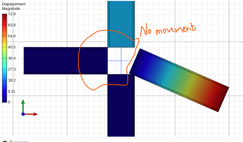

Hi, Looking at the deformed shape, there seems to be some inconsistency with the material definition for the joint2d. Please check how the force-disp (or moment-rot curve) is determined for the joint.
Regarding unit system, you can use any consistent unit system, for example, since you use N-mm, moment of 100 kN-m should be entered as 100e6. Please follow the same unit consistency for other definitions.
