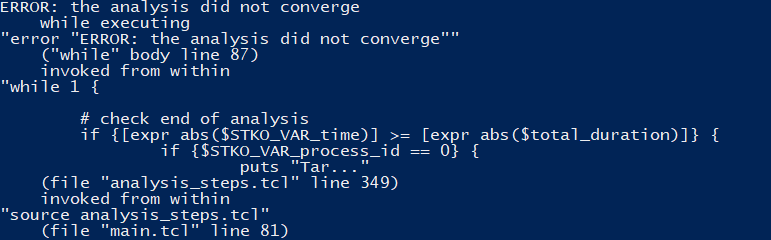

Re: Analysis did not converge
Thank you very much. I did, but still no convergence.
Hi, Please note the following changes that I made to your model, and it now runs smoothly.
1] It seems that pushover load definition has some issue. Time series (ciclica) for the pushover displacement already included a comparable displacement (~28 mm), however the spPrescribed load in the condition again multiplies it with -31. You are multiplying the actual displacement by 31! So, I changed it to -1. You can see the maximum displacement as around 30 from the experimental background curve.
2] Refine the mesh to improve the accuracy
3] Analysis settings (pushover): Increase the numIncr to atleast 5000 since the cyclic loading has many loops, hence increasing numIncr can help achieving good match between the experimental and numerical prediction.

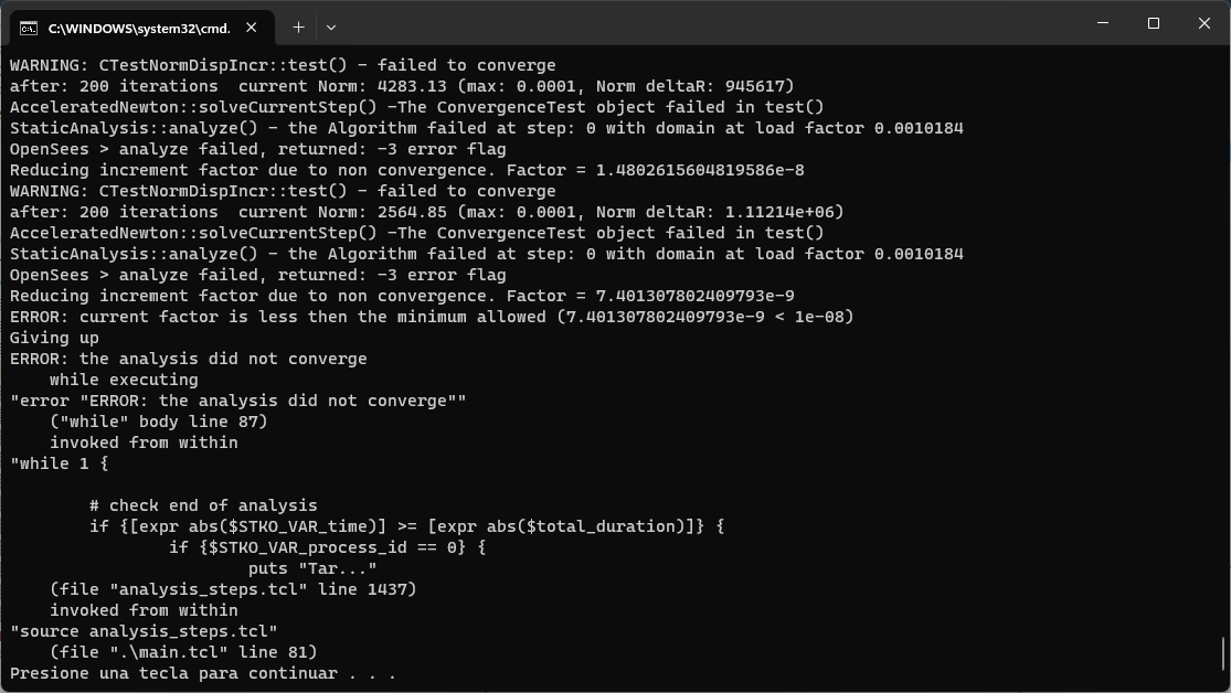

Gabriele.Neri
- Posts: 17
- Joined: Wed Feb 21, 2024 9:14 am
Dear stko team,
I'm trying to do a parametric analysis, but I have some issues with the convergence.
I've tried to use different system solvers (Mumps, UmfPack), I've tried to increase the numIncr, without getting any results.. Can you help me?
I attached the error, the warning and the file I'm testing on.
Concerning the parametric analysis, the steps are the following:
- I created TCL files with the Write Input File command
- I opened a command shell in the directory in which I generated the TCL files
_I launched OpenSees with the number of processors = number of parameters, that are 30 in this case
(C:\OpenSees-Solvers\openseesmp.bat main.tcl 30)
Thanks in advance
Thanks in advance
- Warning parametric analysis.png (14.91 KiB) Viewed 2744 times
- Error parametric analysis.png (23.8 KiB) Viewed 2744 times
- file 0.4g.zip
- (2.18 MiB) Downloaded 234 times
Hi, the issue is with forceBeamColumn element, it is not able to find force/displacement compatibility. I checked the BeamSectionProperty, you have used hinge option with nonlinear fiber model for the middle of the beam or column elements. I suggest this is not necessary unless you go for finite plastic hinge length model at the ends of the beam-column elements. Hence, I modified it to StandardIntergration type with 5 integration points, as you see in the attached figure. Now, the analysis converges.
- TimeHistory Gabriele_rev.zip
- (179.79 KiB) Downloaded 234 times
- forceBeamcolumn.png (16.7 KiB) Viewed 2734 times
