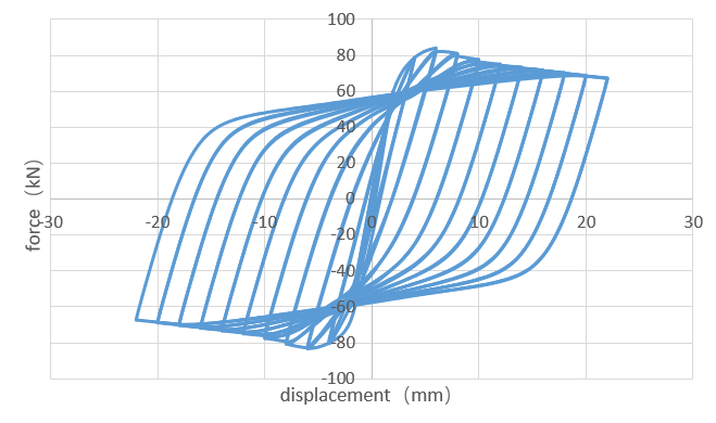

However the force-displacement curves of the vertices I got from checking the running analysis don't seem to be quite normal, the graph below is the result I got before I added the zero-length element, and they are so different from each other, can you help me again to see what the problem is? Thank you again!

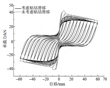

Sure. To start with an example, Figure 1 below shows two hysteresis curves, where the black curve takes into account bond slip between the reinforcement and the concrete, and the gray curve does not take into account bond slip.kesavapraba wrote: ↑Thu Jan 11, 2024 1:33 pmHi, To better understand your analysis, I'd appreciate some additional explanation on how you compared the numerical results. Providing details on the comparison criteria and, if possible, a visual representation like a figure or chart, would be immensely helpful.
My goal is the same, to use zero length elements to make a comparison of the hysteresis curves of my columns before and after taking bond slip into account, the hysteresis curves before adding the zero length elements are above where I have attached them.

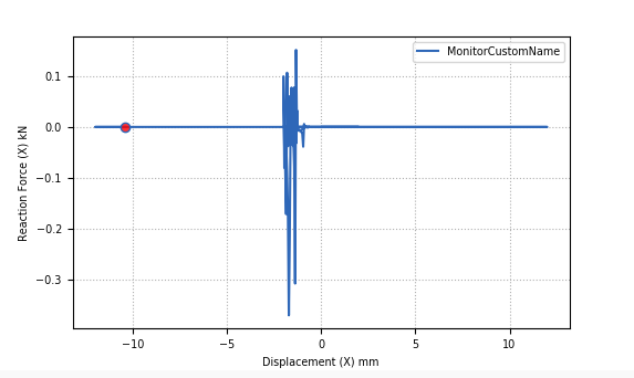

The hysteresis curve I got after running the model you modified for me was anomalous, and although I made some adjustments to it later, the results were not satisfactory, attached is a plot of the anomalous analysis results.
