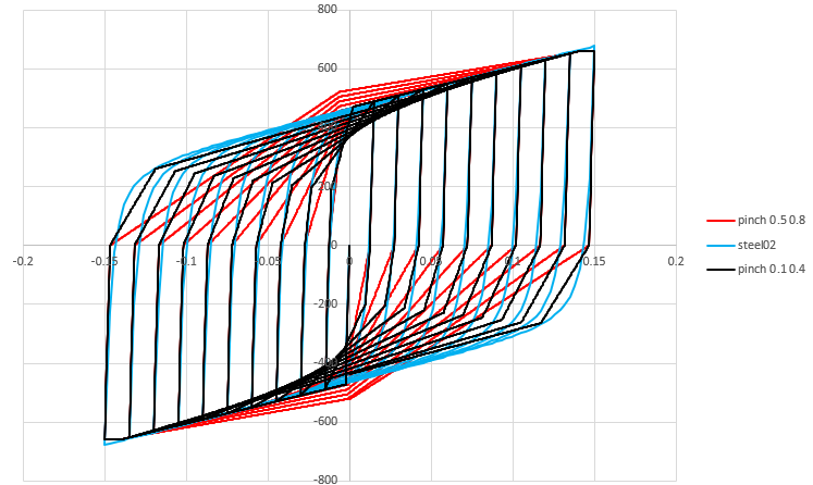

You can also try with the pinching parameters of your hysteretic material to make it match the curve of a steel02:
