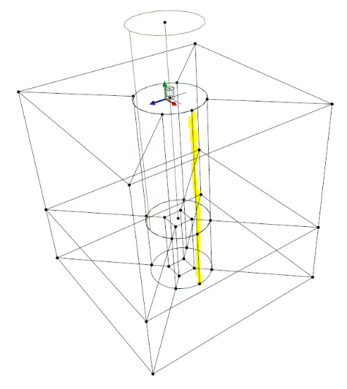

Thank you, but I am still having an issue with creating my geometry and meshing the model. As I said, I am trying to redo the example (E-Learning Course Soil-Pile Interaction - Modeling with STKO's Python API on YouTube; https://www.youtube.com/watch?v=iDgFM-ZjHVo), but with a slightly different geometry.
1) There is a line that was generated by extruding a circle (see yellow highlight in the screenshot below) when I was trying to replicate the model from the example. This line is creating problems as STKO reports that there is a mismatch with DOFs at nodes where this line intersects with solid elements.

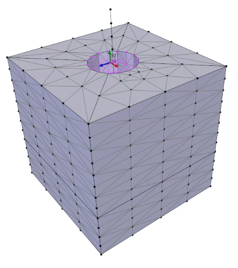

2) For some reason, even though I selected the structured Hexa/Quad mesh, my mesh is still triangular (see second screenshot below). I am not sure how to change this.

That line is created by the extrusion of the circle. More specifically, by the vertex used as the second point in the construction of the circle.
The reason why it does not allow a structured hexa mesh is because that extra line creates faces with more than 4 vertices and 4 edges, thus not a candidate for structured meshes.
In the webinar example, I avoided this by creating a circle using a direction (second_point - first_point) of 45° from the global X-axis, so that the vertex will coincide with the diagonal lines created at 45°.
Now, since you already did it this way, I used a simple trick to make all the faces 4-sided.
I simply created 2 orthogonal planes along the global X and Y directions passing through the center.
I used them to cut the solid so that all sub-geometries are candidates for structured mesh:

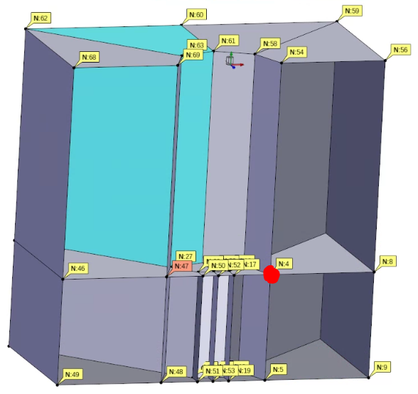

Thank you very much for the quick response. Makes sense. The mesh now is indeed what I wanted. However, the model doesn't run because there is an error that NDOFs are not consistent (3 vs 6 DFOs at the node). I did some investigation by reducing the number of elements to locate the node where this happens, and it seems that it is a node at the base of the face of the opening in the soil (see screenshot below).
When I delete that line, the face disappears and the problem moves to the next one. If I delete the entire face of the opening, there is no problem. I don't understand why would a line have any DOFs and I am not sure how to solve this problem. This problem doesnt occur in your model. Can you please advise or fix the problem?

Here's a fixed version of your file:
Pile_v1.zip
(295.5 KiB) Downloaded 433 times
Both interactions using the BeamContact3dp or BeamEndContact3dp must be node-to-element.
One was missing the material property
The side interaction was missing the assignment of the cylindrical local axes
Pay attantion to convergence issues given by contact!

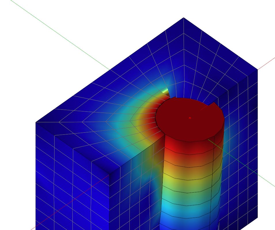

Hello, again. I am still working with this model and I decided to simplify it by trying to connect the pile (modeled as beam-column element) and the surrounding soil in a way so they move together, without modeling contact using contact elements. I am using beamtoSolid multiple constraints to connect the pile to the soil domain at the sides and Equal DOF constrain at the base. When I plot the deformed shape, it appears that the pile is penetrating the soil only at the very top (see screenshot below).
Also, I am doing a force-controlled analysis using 10,000 kN, but the overall total reaction at the end of the analysis is 120,000 kN. Not sure why is this. When I use exactly the same analysis settings in models with explicit contact modeling, the two numbers match,
Can you please let me know what could be causing these two issues? I attached the model for your convenience.
