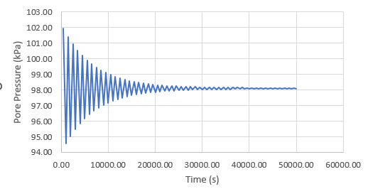

I am currently conducting a gravity analysis using transient calculations with numerous steps (500) and large time steps (dt=500s). In the graph depicting pore pressure at the nodal point of -10m within a 1m x 1m x 10m soil column, the pore pressure converges to a valid value of 98.1 kPa by the end of the analysis.
Screenshot 2023-11-21 173815.png (21.16 KiB) Viewed 5047 times
However, during the convergence process, there is noticeable oscillation between 102 kPa and 95 kPa. Interestingly, when I experimented with altering the density (ρ) value of the soil column, the amplitude of the oscillations increased with increased density (ρ) before ultimately converging to 98.1 kPa. No explicit damping (Rayleigh) is applied in the analysis.
I am curious about the potential reasons behind this oscillatory behavior and its eventual convergence, especially given the absence of damping inputs.
