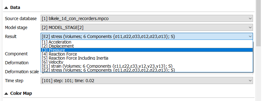

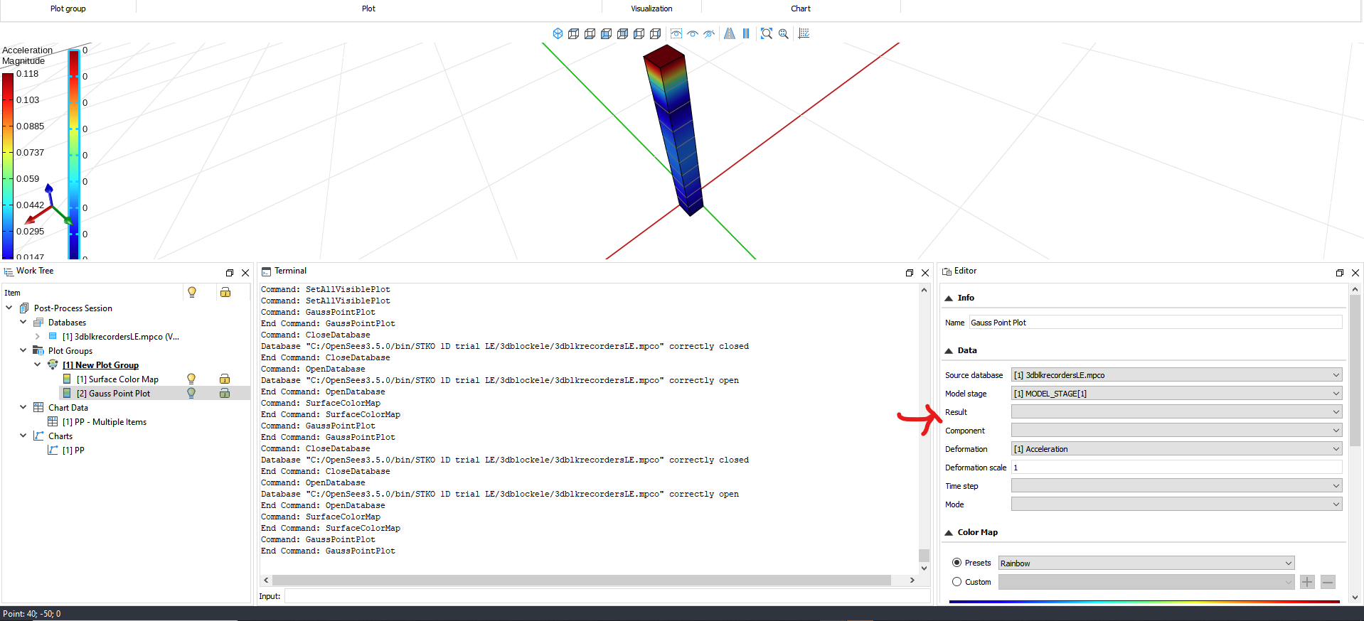

I am writing to enquire about the post processing visualization of stresses in my model. I am currently using a 8 nodded SSPbrickUP element to model a column of soil under pressure.
I am unable to view the stresses in the column. I have used the gauss point plot option to try to view the stresses in the soil column. However, I am unable to select the option of viewing the stresses.
Screenshot 2023-11-14 225756.png (171.11 KiB) Viewed 6991 times
I have also checked he analysis script, and it does includes the recorders for stress and strains.
Screenshot 2023-11-14 230203.png (11.7 KiB) Viewed 6991 times
how can i view the stresses and strains recorded from this model?

Hi, i believe found the answer in one of the past posts in the forum. is this the one?
Thu Jan 13, 2022 6:15 pm
That's because the SSP brick elements do not support the "material" keyword before the "stress" keyword (they have only 1 integration point)
So you can simply use the custom results an input "stress" only:
Re: RE:Post processing visualization of stresses and integration points
Post by kesavapraba » Thu Nov 16, 2023 10:59 pm
Hi, Yes you can use stress option as mentioned in the post.

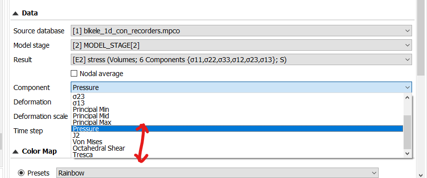

I was wondering if you could give a little more details on the components listed tin the results of 'Stress'.
Screenshot 2023-11-20 113202.png (24.71 KiB) Viewed 6904 times
In particular, is the pressure component listed in [E2]stress, the figure above, the same as the '[3] pressure' results under the results tab(figure shown below)? I am currently using using a SSPbrickUP element.
Screenshot 2023-11-20 113433.png (24.38 KiB) Viewed 6904 times
From the output results it doesn't look like the they referring to the same type of pressure. Could you provide a little more detail on it and perhaps the difference? There's little information in the documents and in the manuals. Thank you, your help is appreciated!
Post by STKO Team » Tue Nov 21, 2023 11:05 am
The last components in the stress result are useful stress invariants computed on-the-fly by STKO.
Instead, the pressure in the nodal result is the fluid pressure for U-P elements

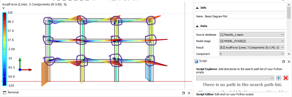

I found how to see V in the elements of my model, but I need to see the values close to the nodes (as marked in violet in the picture "Taglio (1)"). I need them in order to perform the shear verifications.
Is it possible to extract a sort of table in which there are the shear values and the corresponding section?
If not, how can I get the shear values of beams and columns close to the nodes?
Thanks in advance
