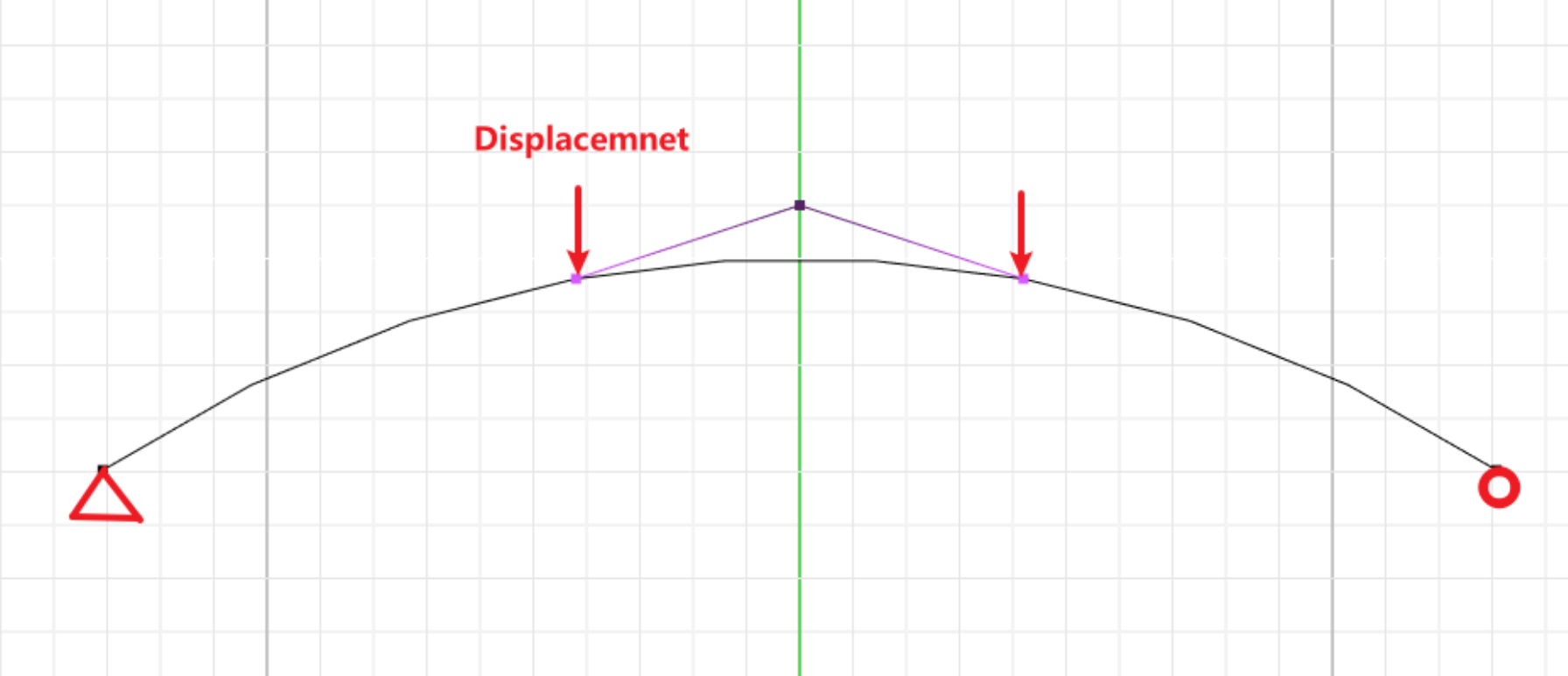

I wanna simulate a four-point bending test for a curvilinear beam with a displacement-time control.
I tried two methods.
The first is using the analysis integrator-'loadcontrol' command with a 'sp' constraint determining the ModelType as Displacement. However, it always can't compute the element force.
The second is using the 'displacemntcontrol' command with a 'nodeforce' constraint determining the ModelType. However, it can't converge.
Here, I want to know the use of the above two methods to add a displacement-time history to my model.

Hi, It is not clear where the loads are applied on the structure during lab testing – please provide us with details about the loading location in the geometry.
Can you also provide the drawing of the geometry with the units (mm or cm or m)? As per the geometry from the model, it seems that the base length of your model is only 262 mm! Please also mention the unit system that you used in the model (N, mm, sec?).

Yes, the units are N/mm/s.
Because I'm conducting a test with a scaled curvilinear beam model, the geometry is only 267mm.
The displacement-time history is loaded on the middle two points and the maximum displacement is about 20mm.

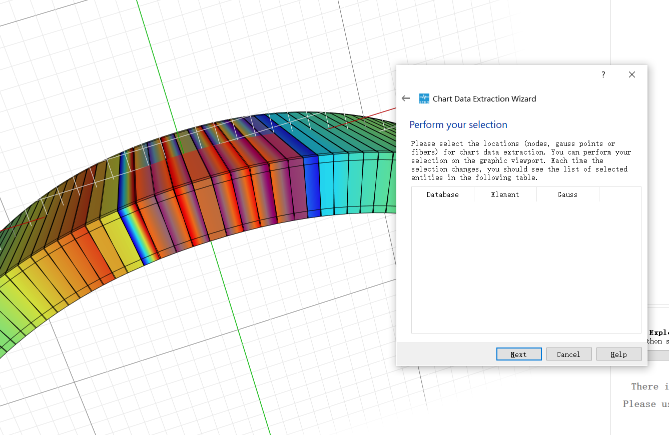

And, I set a recorder in the analysis part while I can't chart the element-force curve even though It can be shown on the plot group. Can't STKO do this?

[1] In the preprocessor, select section.force option in MPCO recorder. You missed this one.

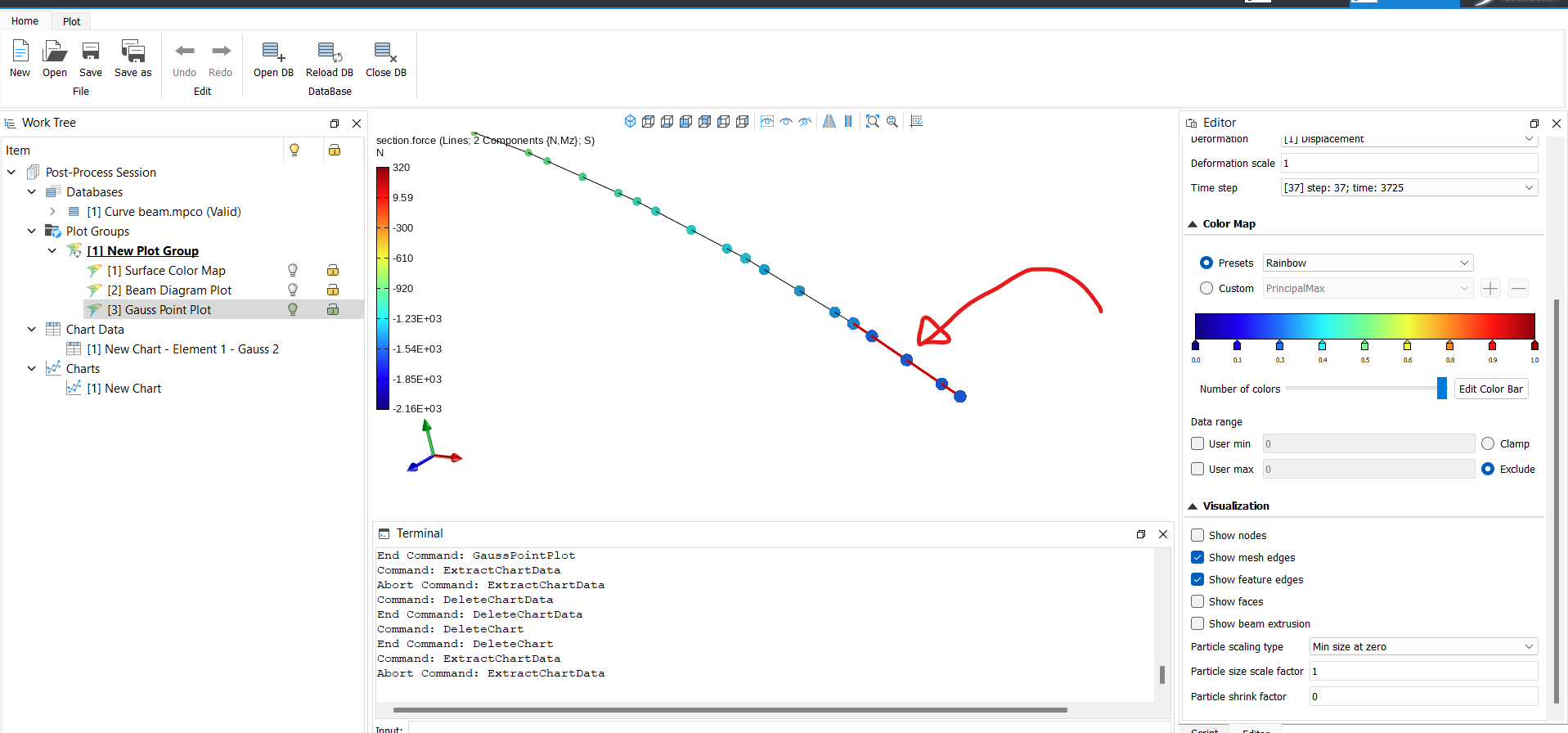

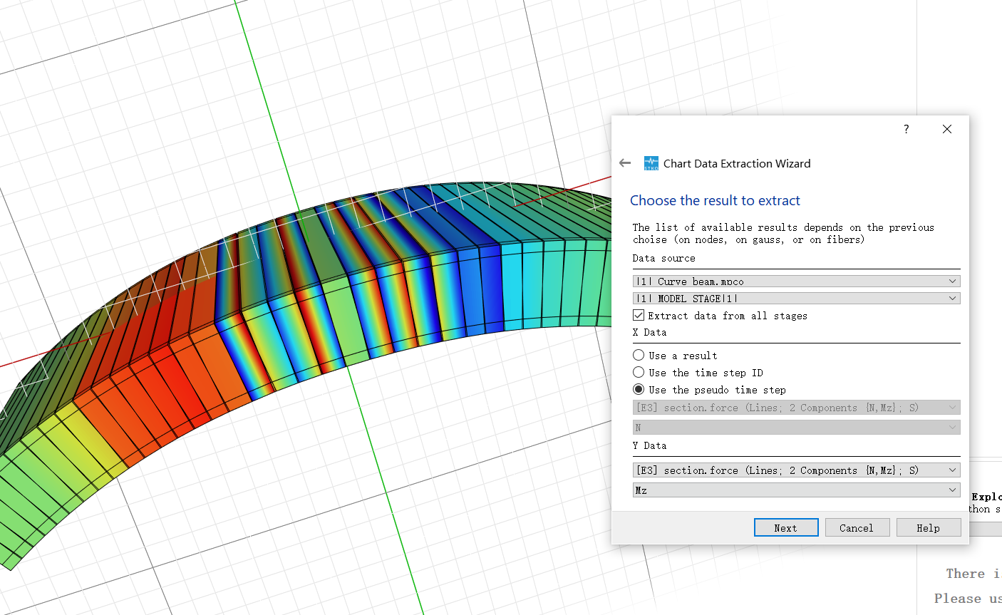

[2] In the postprocessor, create Gauss Point Plot -> You can see 5 Gauss points for each element (see attached figure below) -> Select the Gauss point where you want to get section forces -> Chart Data -> On element Gauss point -> Section.force (either N or Mz).

STKO can get you the section forces, but you should use the correct option in post-processor. In your case, the dispBeamColumn uses fiber section propoerty with 5 integration points. Please do the following to get the section forces:And, I set a recorder in the analysis part while I can't chart the element-force curve even though It can be shown on the plot group. Can't STKO do this?
