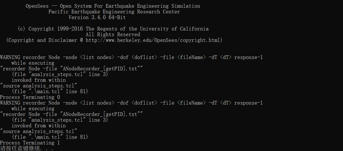

Thanks!
Could you please tell me how to find and use the Python API?
I tried to add a customCommand which you mentioned "recorder Node -file "ANodeRecorder_[getPID].txt" ".
The results showed something was wrong, and I hope you can help me explain it.
I appreciate your reply!

Re: Masonry example without fully postproces
The error is saying that you forgot to:
https://opensees.berkeley.edu/wiki/inde ... e_Recorder
- Add the node or list of nodes
- Add the dof
- Add the result

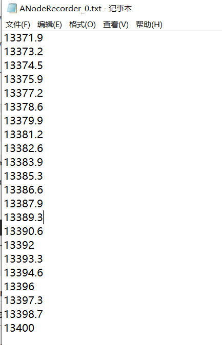

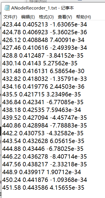

Thanks!
I tried as you pointed out with a command " recorder Node -file "ANodeRecorder_[getPID].txt" -time -node 1 2 -dof 2 disp; ".
It did show two files with the name "ANodeRecorder_0.txt" and "ANodeRecorder_1" because I divided the model into two parts.
However, the two files can't make up to a complete one. One contains three columns and another only has one.
What's wrong with it?
It's correct:
You asked for time + Uy of nodes 1 and 2.
The first column is the time (in both files).
The other 2 columns are only in the second files because those nodes (1 and 2) are only on the second partition
