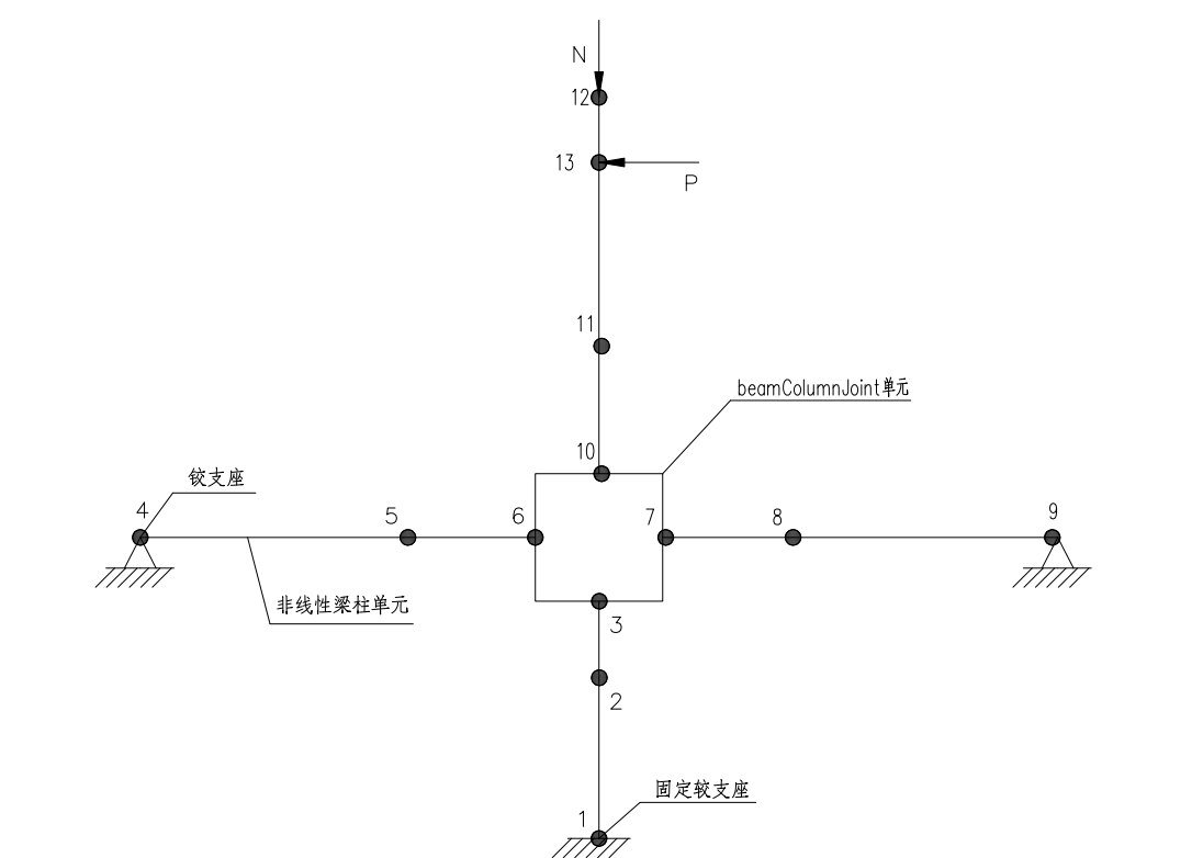

Dear STKO team, during the analysis, I set up two analyses, the first time I applied the column end axial force, the second time I wanted to get the hysteresis curve through horizontal displacement control, but I couldn't run the second analysis, can you tell me what to do?

Dear STKO, I have found a solution to this problem, now I have a new question, I applied a force P in the X direction at point CN1(13), and at the same time I want to use the displacement control for hysteresis, and finally get the hysteresis curve, can you tell me how to get the change curve of P in STKO?

You can use a Displacement-Control integrator.
There, instead of using a Target displacement, you can provide a Path time series where you have the displacement cycles
