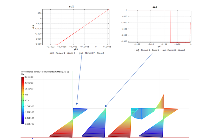

I would like to ask you from figure,
As seen in the figure, ModIMKPeakOriented is defined at both ends of the beam, but from the figure on the right, it is seen that positive and negative moments occur at the beam ends.
My question is why the positive moment related parameters defined in ModIMKPeakOriented don't work, why it doesn't give the positive moment and rotation relationship from GaussPlot.
I would be glad if you can help me if there is a place where I went wrong.

Could you please explain better what is your issue?
Your positive strength is lower than the negative one, so it fails on the right corner, and since the residual strength in the positive side is 0, it creates a perfect hinge at the end of the analysis.
