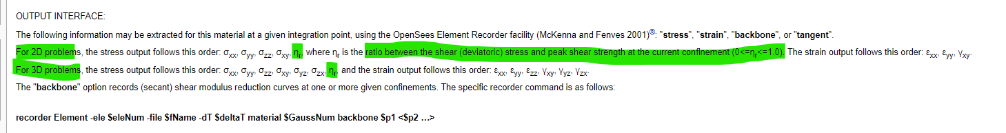

The stress tensor will have a last extra component that tells you if you are in a nonlinear state:

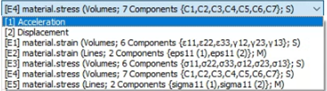

Here are the responses I can obtain for my soil elements model with pressure-dependent/independent materials you mentioned (see the first screenshot). Can you please explain what are the C1, C2, C3, ..., C7 are the parameters? Why is there 7 of them?

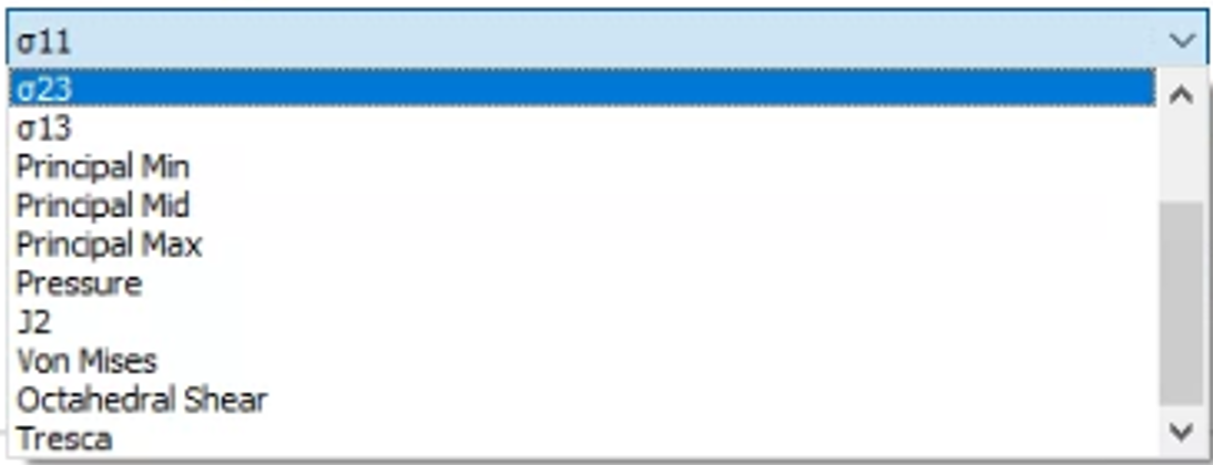

Regarding the second screenshot, which shows different stress components, can you please explain the meaning of all parameters other than Sigma,i,j (Principal Min, etc., Principal Mid, etc.)? Which parameter is the stress ratio parameter you mentioned from all these parameters?

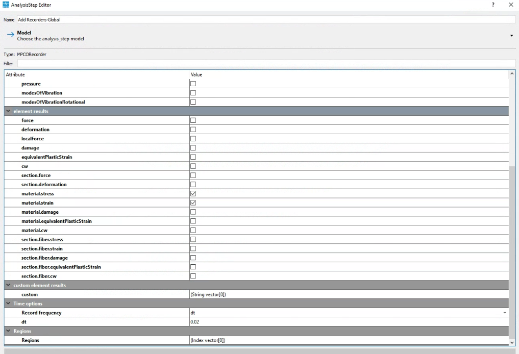

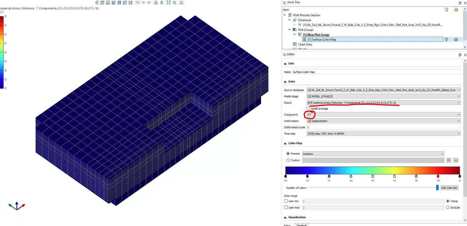

I have a follow up question. After running the analyses with my model in which soil is represented with Pressure dependent/independent nonlinear materials for soil, I realized that all stress results are zero except C1, C2, .., C7 parameters (see screenshot below). I changed the material to Elastic Isotropic and re-run the analysis and all results were there. Is there anything I need to do in particular when defining recorders for nonlinear soil materials to obtain the results? You can also see a screenshot of how I defined my recorders.
I have send you the model via email so you can take a look.

It's because the developers of those material models decided to put in the "stress" result, 7 components.
The first 6, C1 to C6 are the stresses (s11, s22, s33, s12, s23, s13)
The last component C7 is the eta parameter in the description we posted previously. It tells you if the material went into a nonlinear range.

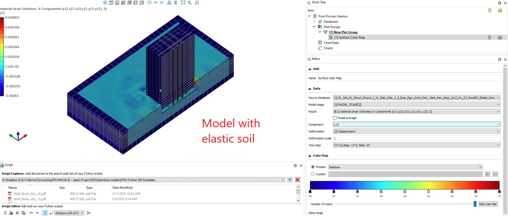

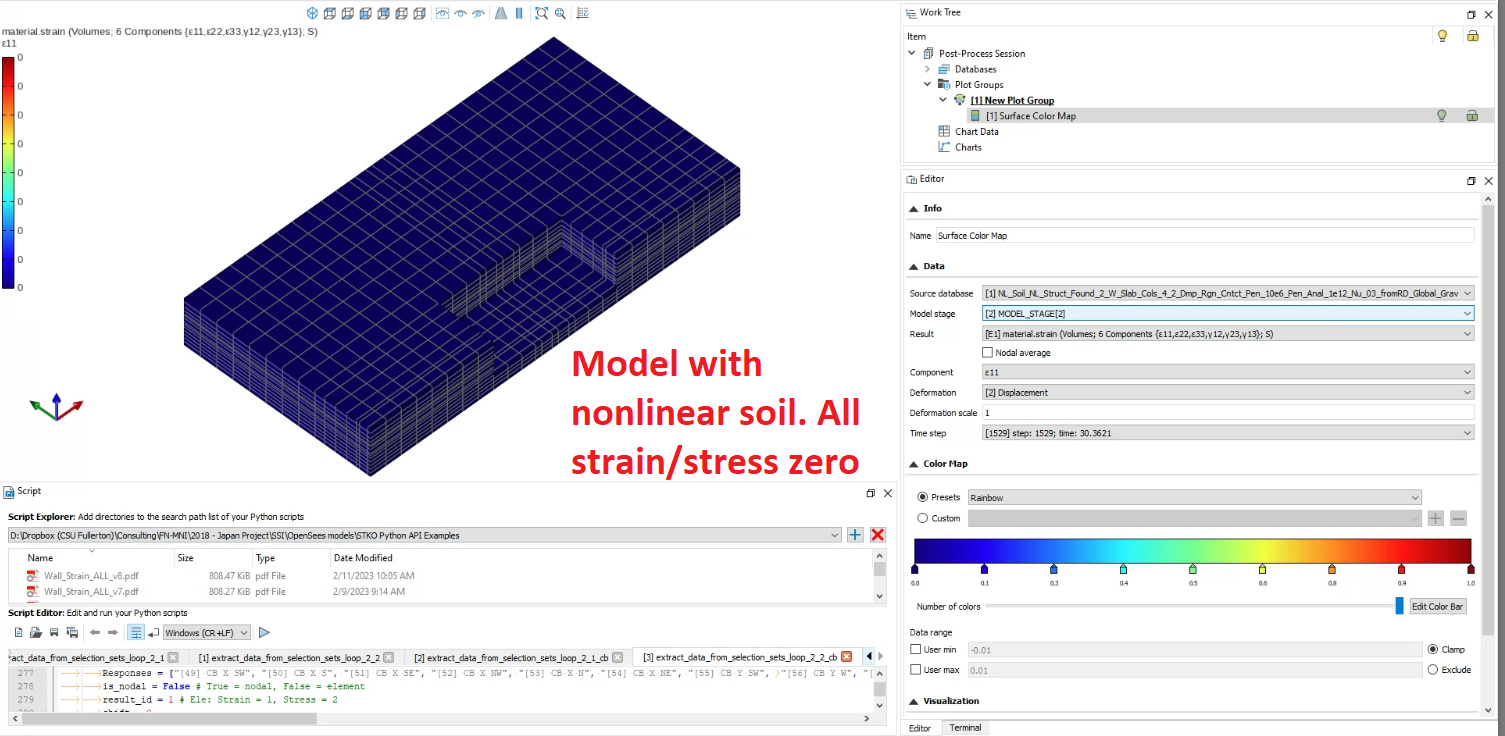

I see. Unfortunately, when I plot C1, C2, .., C7 parameters, they all show results except C7, which is the most important one that I can use to figure out if the material goes into the nonlinear range (see screenshot below). As you can see there are no results and the scale is all zeros.
Also, how do I get the strains? Strain results (eps11, eps22, etc.) are also blank. Is there anything I should be defining differently in my recorders? Please let me know.
It's because your material is never updated to plastic.
Those material models are supposed to be used like this:
  1. By default they start as elastic material (they need an initial state of stress before being used as nonlinear)
  2. Add gravity loads and run a gravity analysis (keep load const and reset time to 0)
  3. Update materials to plastic
  4. Re-run the same gravity (without adding extra loads, it's just used to correct the previous analysis in case some element are not anymore in the assumed elastic regime)
This is the workflow:
Were the update is done like this (custom command):
set nl_soil_tags {1 2 3 4 5 6 7 8}; # put here the tags of your PDMY physical properties
foreach mat_tag $nl_soil_tags {
	updateMaterialStage -material $mat_tag -stage 1; # 0 = elastic (default), 1 = plastic
Unfortunately, those material models give some inconsistencies in the XML tags of the setResponse method. A simple workaround is to ask for "material.strain" (this will work for other materials), and "material.strains" (this will work for the PDMY)
