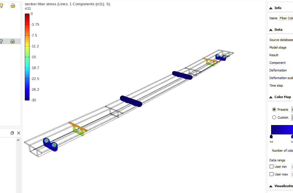

It was singular from the beginning because you forgot to input -GJ (if in 3D you leave it as 0, your beam will be singular in torsion)
Now it will run for some steps and then it will stop converging because parts of your beam are crushing (and you did not put any steel in there):
