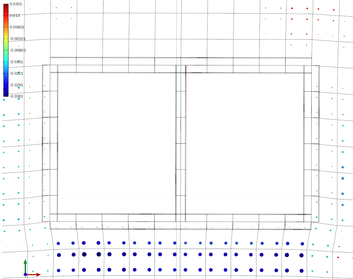

like this
The presence of Gaussian dots can be clearly seen in the soil element, but not in the structure

Re: Unable to find Gauss point of structural element in post processing
It's because you are using the ElasticBeamColumn element. Since it is an elastic element it's analytically integrated (does not have gauss points or fibers in gauss points).
You can ask for "localForce" results and you will be able to see a beam diagram plot.

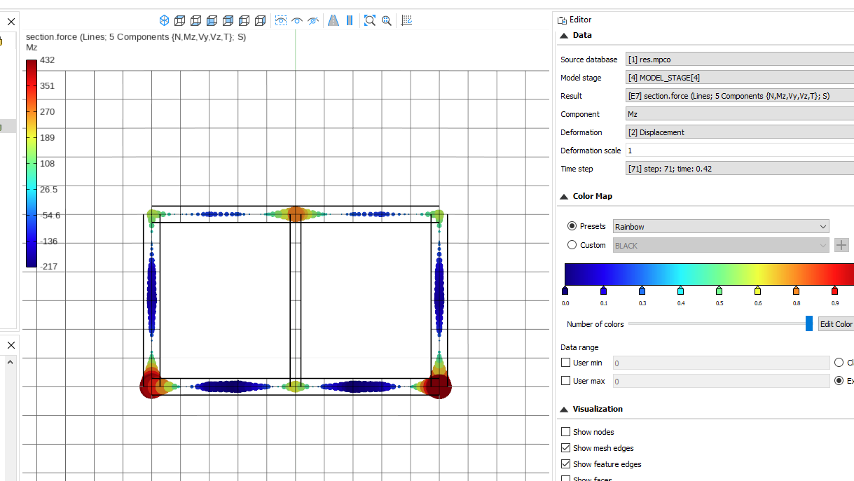

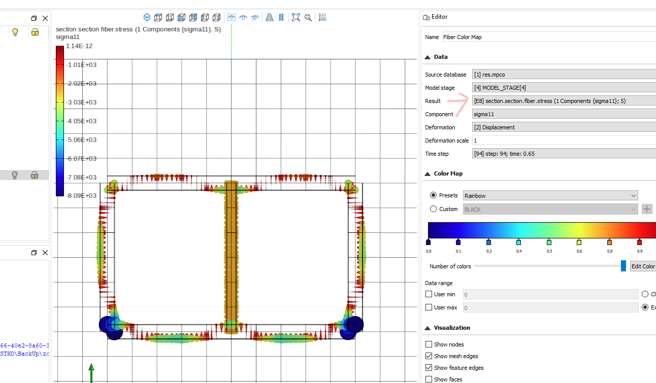

For a Gauss Plot you can see section.RESULT (i.e. a RESULT located at the section-gauss-point):

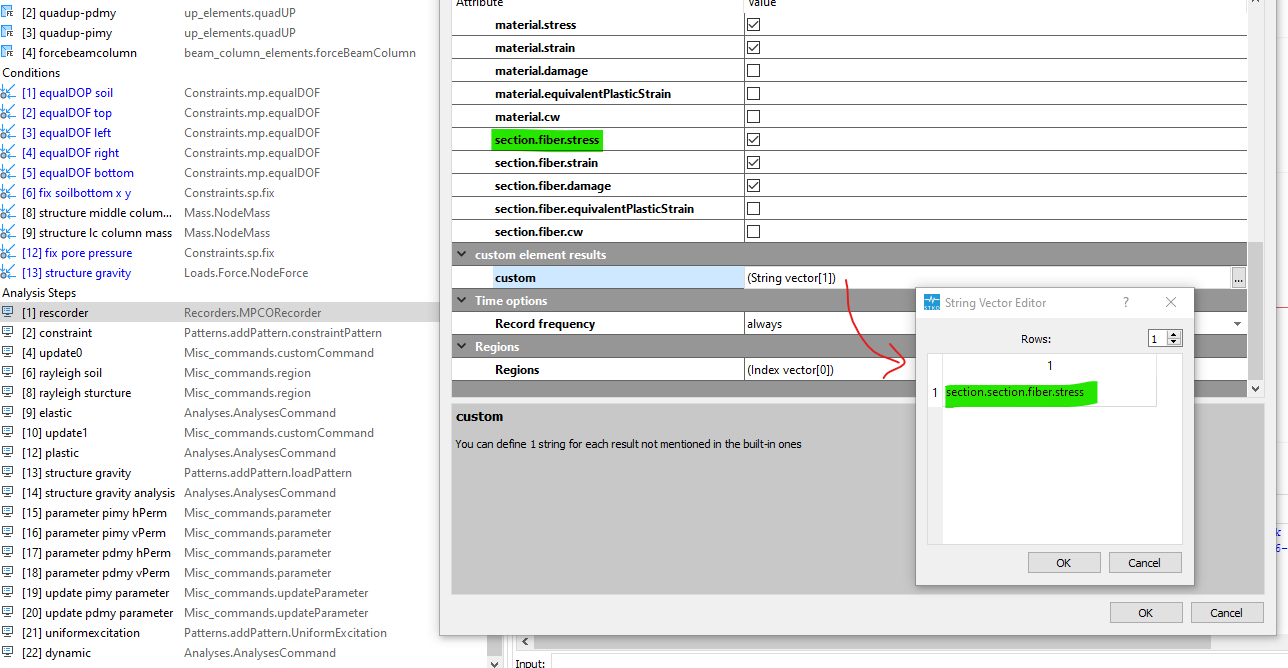

For a Fiber Plot you can see a result like section.fiber.RESULT (i.e. a RESULT located at every fiber of section-gauss-points): Note: Due to a recent change in OpenSees, if you use a Section Aggregator with a Fiber Section inside, you need to specify twice the "section" keyword, like section.section.fiber.RESULT
Here's a modified file:
