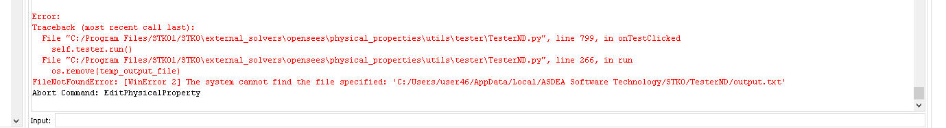

Hi team,
I’d like to test the ASDConcrete3D material model for a numerical calibration of a cyclic test we performed at the University of Minho. However, the material test tool does not work and reports me an error message (see attached).
Could you please help me to fix it?
We have just updated STKO to the latest version v.3.2.1.
Thank you for the support.

That is only the last part of the error message. Could you please scroll up until you see the the OpenSees output? Could you copy-paste that here?

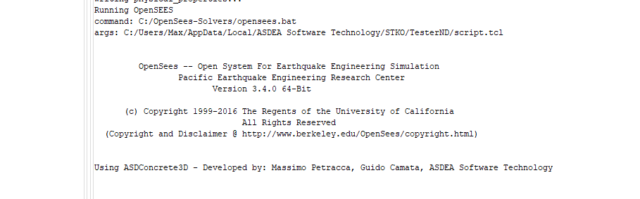

Hi, is this fine? Thank you for the support

It's because you are using an old OpenSees version without the ASDConcrete3D.
Please make sure you are using the lates STKO release and the latest OpenSees-Solvers (download the unofficial version from prof. Tarque's website as the current official version of OpenSees still has to be recompiled with this material)
