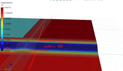

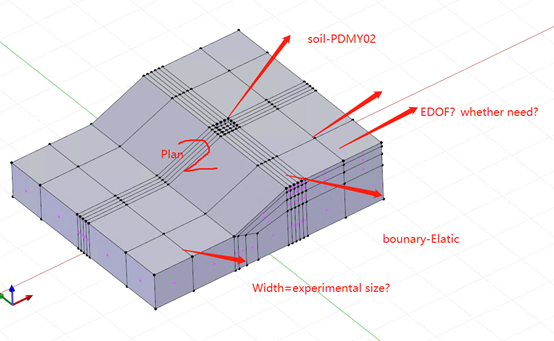

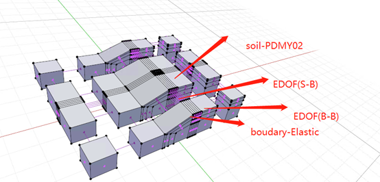

My models are all inclined, and the boundary has a great impact on my settlement results. The conventional shear beam boundary cannot be used. There are too many models to upload completely. I have provided an elastic model.

3. According to the centrifuge test, should my boundary adopt the following scheme (1) or(2)?

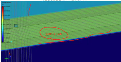

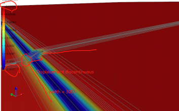

5. Should the width of the model box be the same as that of the test shear box? However, based on my recent research, I found that width has a huge impact on the results,
I think that none of the two are representative of the centrifuge test conditions imposed by the box.
Why don't you try to model the real setup?
For example, you can model the steel box, and the material between the steel box and the soil (I've seen that sometimes they use materials to minimize wave reflections)
What is stated in opensees website about using a Thicker column, is to simulate the free field, which is not applicable to your example.
Yours is a centrifuge test.

Can you show a sketch of the experimental test setup? Probably the free-field model is not the right one
