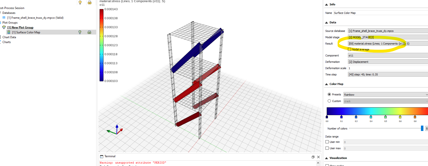

The truss model is fine.
You just don't need to use a truss with a fiber section. The stress will be constant anyway for all fibers. So you can just use 1 material + Area.
In this way, you can ask for material.stress. You can view them in the surface plot, or in the gauss plot if you need to extract data:

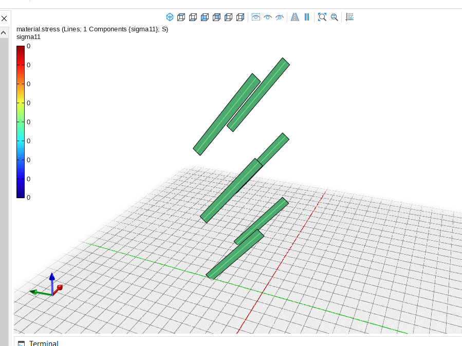

-If I don't make the fiber section of the truss I cannot extract the information in my results, the material.stress that you show in the image is zero.
Why? I see values there. In the image a posted are small, but just because I made a screenshot of the first steps. Are you sure?
I don't know but in the truss elements I can't see anything (the picture is of the results with the truss without fiber section)

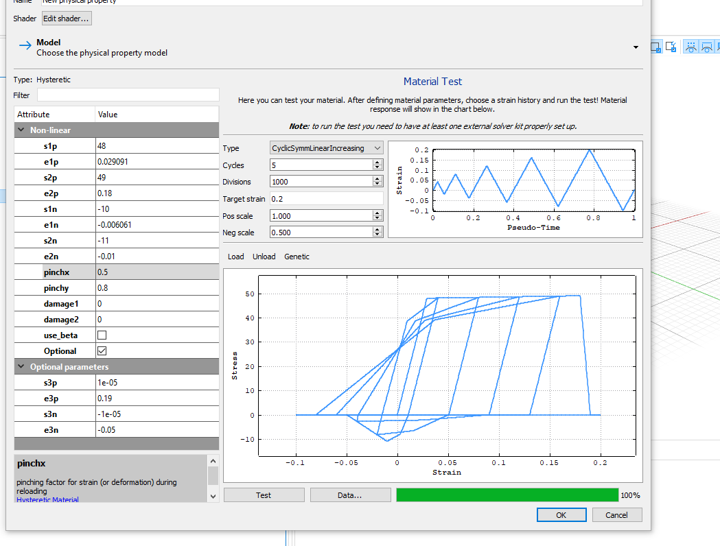

Regarding the material of the brace: my frame is steel but the braces are plastic and indeed they don't work in compression (or have small strength) they only work in tension (E=1650Mpa, σ=48 MPa, εelatic=2%, εbreak=18% as provided by the manufacturer).
The idea is to break the braces in tension when subjected to earthquake excitation, so as to design the proper cross-section of the brace to ensure the damage during the test.
Ok so probably it's because you are using an old version of OpenSees when the truss elements only supported the "-material" keyword. Now they support both "-material" and "material".
Try to download the latest version of the OpenSees-Solvers.
You can use a Hysteretic material:

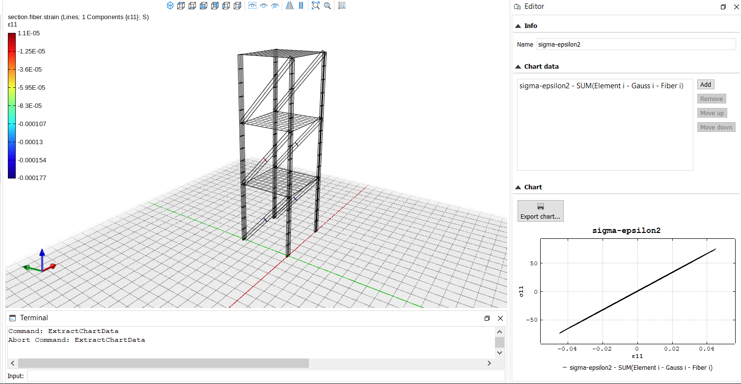

In addition, I change the material for the hysteretic one shown in the post before and I have a problem, the response of the truss brace (to which I assign the material) is not following the material, the response is linear and working in compression when it was defined not to work in compression. I attached a picture showing the response of the brace which stands -50MPa when it was designed not to, and also does not evidence signs of plasticity as it should.
The problem is another... It's more than 50 MPa just because you selected many fibers and you used the SUM operation. So it's summing up the contribution of many fibers.
Try to select only 1...
