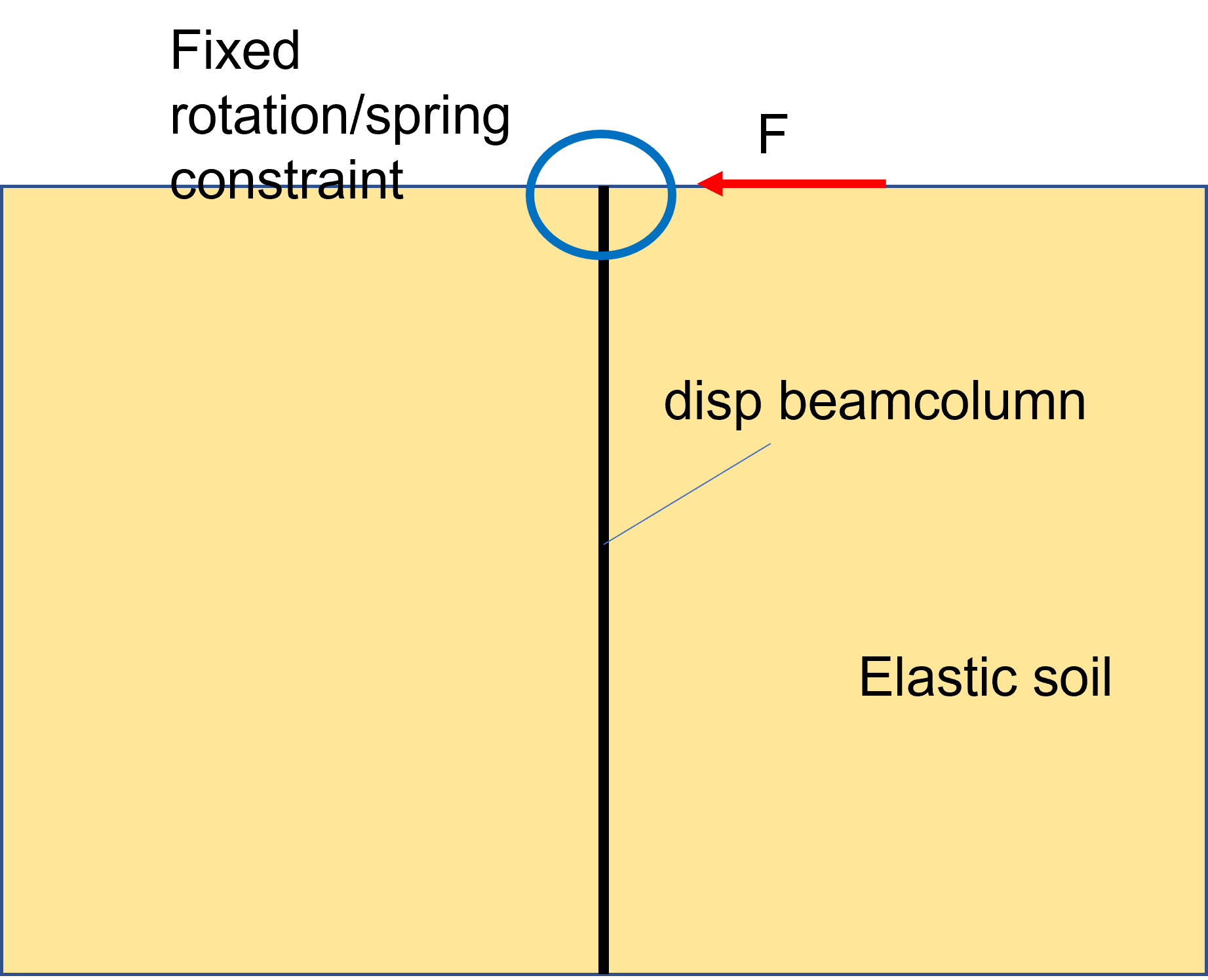

Hi, thank you for the response. Here is a sketch. It is a simple 2D model of a pile in an elastic medium. The only force is the horizontal force at the top node. The top node of the pile can be either free to rotate or fixed against the rotation if I add the fixed constraint, but I would like to insert a rotational spring to determine the degree of fixity of the top of the pile.
Please let me know if you need more details.

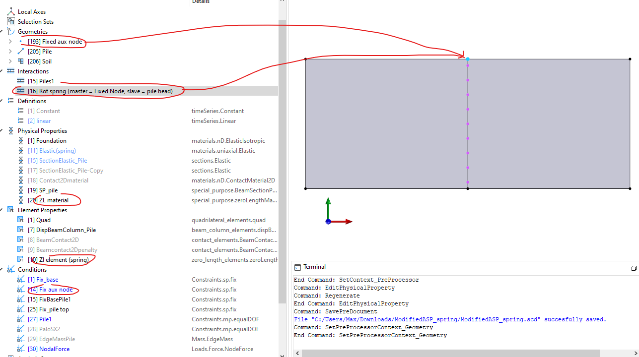

Ok so in this case what you have to do is:
  1. Create an auxiliary node, coinciding with the Pile Head.
  2. Fix it in all DOFs
  3. Create an interaction (node-to-node, master = Auxiliary node, slave = Pile head)
  4. Add the zero-length with rotational spring to the interaction
fix pile rot.png (92.6 KiB) Viewed 3323 times

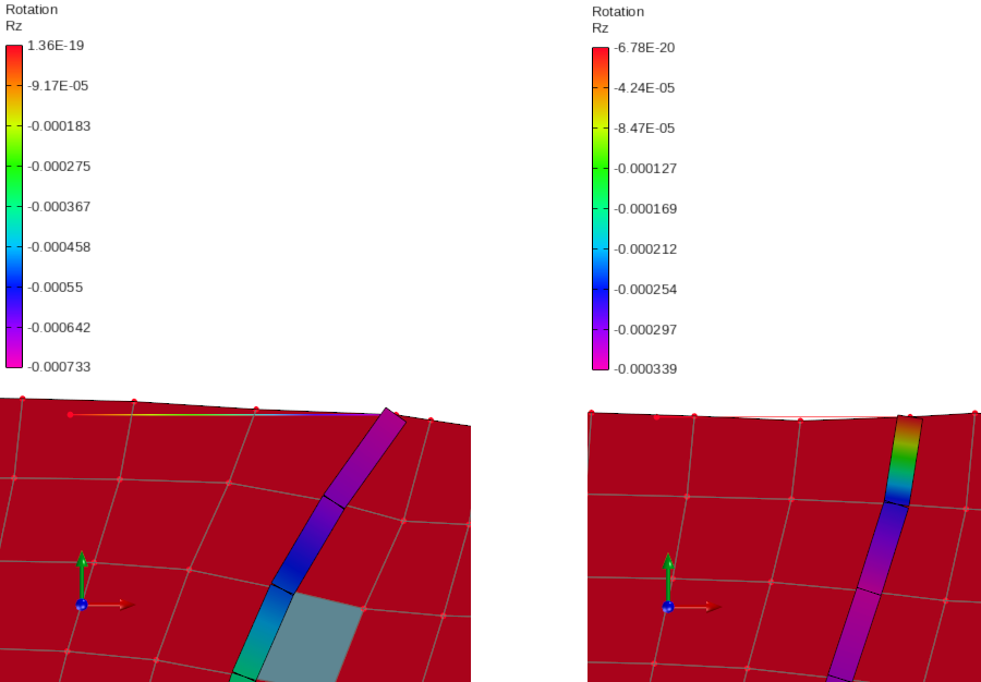

Here's what you get with K=1 (Left) and K = 1.0e8 (Right)
