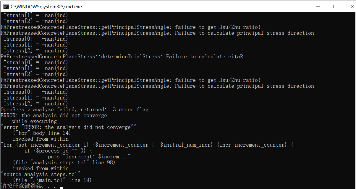

Hello, I am a beginner of STKO software. During this period, I built a shear wall model, but there were some mistakes during the operation analysis, FAP material could not find the direction of principal stress, and there was no post-processing result. I don't know how to debug such mistakes, so I want to see how others solve this problem.
Any suggestions on what may cause this is very much appreciated. The model is added.

First of all, thank you very much for your advice.According to your suggestion, I revised the material related to FAPrestressedConcretePlaneStress. However TendonL01 material cannot be tested, and ConcreteZ01 material test type varies greatly in Stress value, and there were still something wrongs with the material of FAPrestressedConcretePlaneStress during the analysis.
In addition, I downloaded a correct layered shell shear wall model from the forum, and the wall material was changed to FAFourSteelRCPlaneStress material, but Errors related to FAReinforceConcretePlaneStress will occur after the layered shell model can only run partially. I don't know why FAFourSteelRCPlaneStress material is used. but the model analysis showed error related to FAReinforceConcretePlaneStress material.
Any suggestions on what may cause this is very much appreciated. The Modified model and layered shell model wear added.

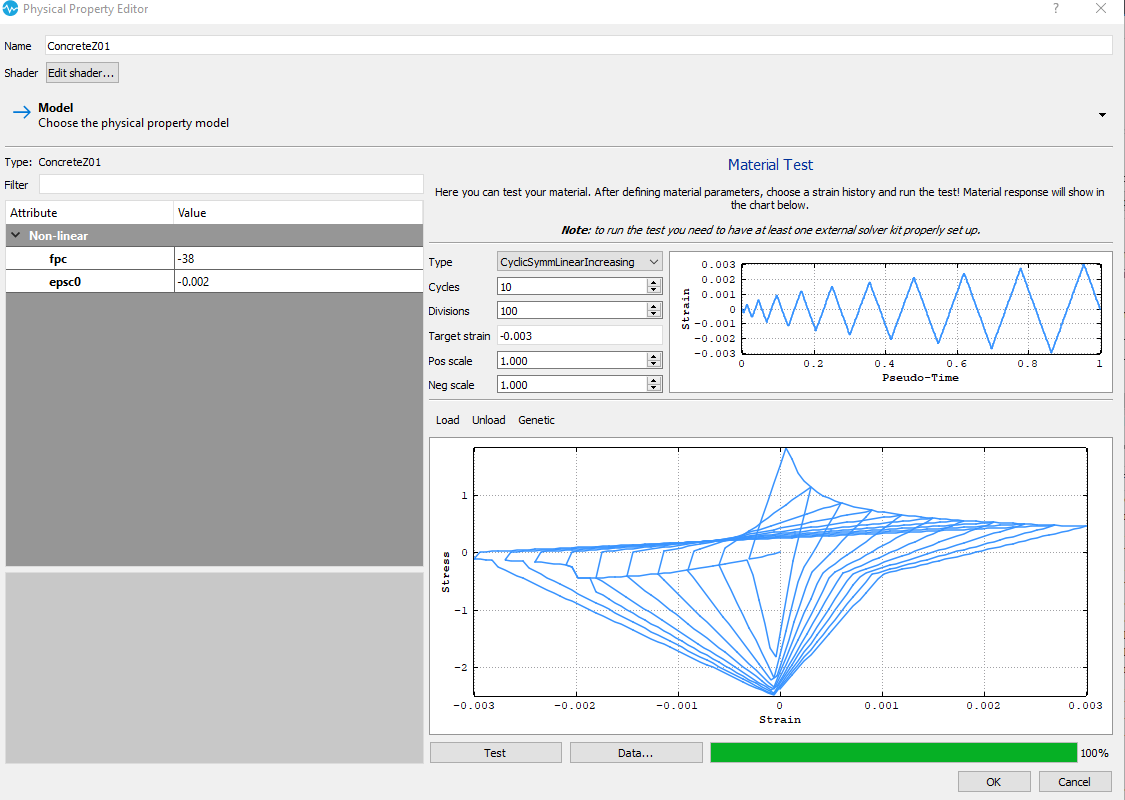

I just had a look at the ConcreteZ01, and if you test it in a cyclic test, you will see how inconsistent it is:
Don't use those materials, even in the OpenSees documentation they say that lots of them do not work correctly.
In my opinion, you will never make it work, simply because those materials look non properly coded. Try to have a look at our webinar on shear walls to see some alternatives (webinar #2)
