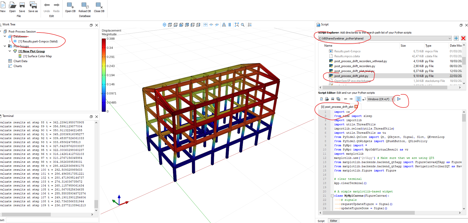

Hi, I am new to using the python API. I am trying to run the files from the intro to python API 2 workshop downloaded directly from the asdea website (ex: 04_drift_opensees_sp from https://asdeasoft.net/?webinar). I input the Results.DB file. However, all the python scripts, for example 'post_processor_drift_script', that I am trying to run get the following error; "name 'os' not defined" even though it is imported in the first line of the code. Do you have any insights on this error?

That's strange.
Could please a screenshot of the whole error window? with all the stack trace?
Make sure you followed all the steps:
