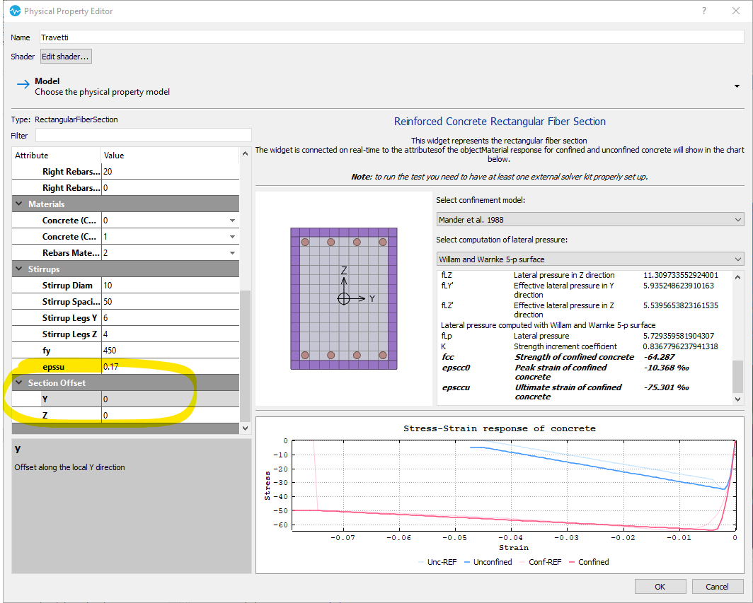

To answer your other post, to see the stress in the plates you need to request section.fiber.stress in the recorder and then create a fiberPlot in the postProcessor once you have your result database.
To align the travetti you can use this options in the RectangulaFiberSection.
