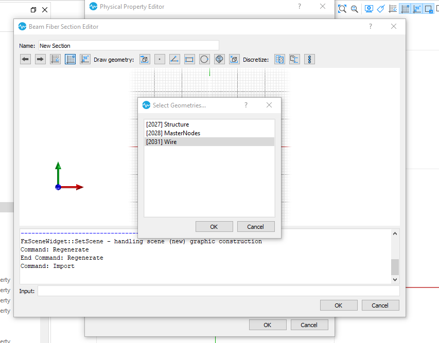

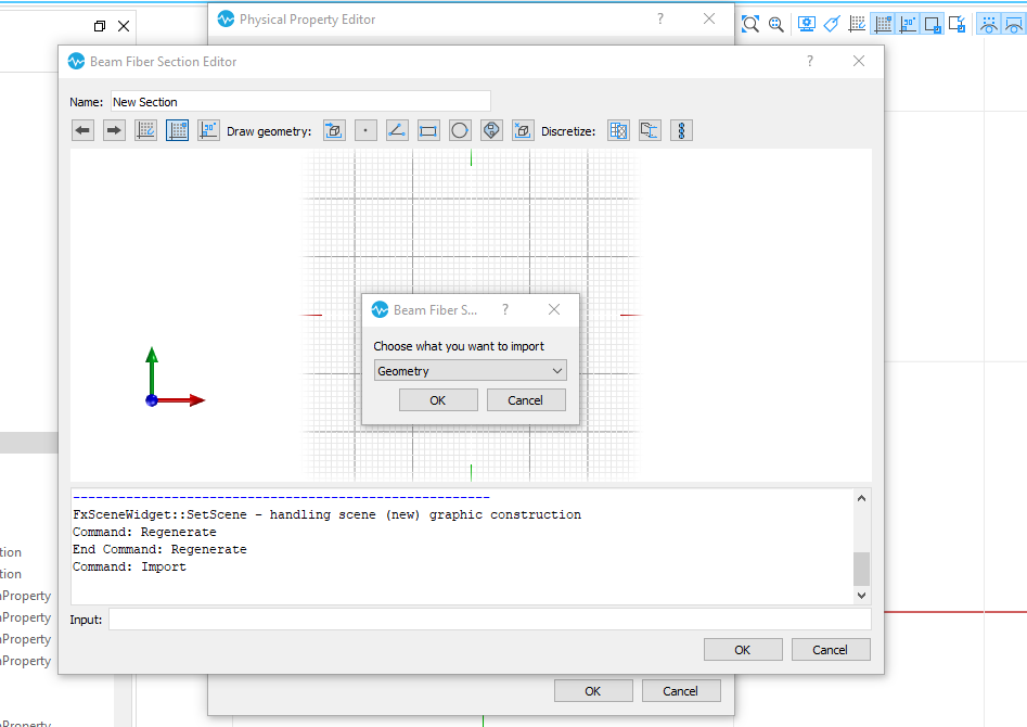

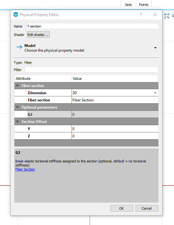

As for how to insert reinforcements in the T and L sections the procedure is the following:
You draw your section geometry in the render view.
You create a Fiber physical property choosing it among section and import the geometry you just created
Then you create a surface and following a surface fiber.
After you created your section like this you can draw the section of each reinforcement you want to add and import it also in the fiber section (remember to create holes in your original face, just follow the terminal instructions in the fiber editor). Also for the longitudinal reinforcement you can create surface fibers and assign the relevant material.
