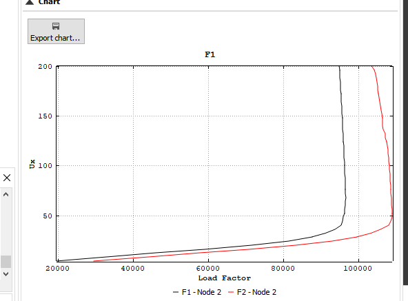

Here is an example where I do 2 independent vertical-horizontal analysis pairs:
the first one has 2 analysis: a vertical one with N = -100 kN of vertical load, and then a pushover.
the second one has 2 analysis: a vertical one with N = -200 kN of vertical load, and then a pushover again.
As you can see from the output of the 2 horizontal analyses (stage 2 and stage 4) they restart from 0 as expected.
Immagine 2020-12-03 154137.png (13.54 KiB) Viewed 3405 times

ok thx.. but this works only with horizontal analysis, not with vertical analysis. At the end of the stage 1 the Rfz is 100000 and at the end of the stage 3 is 300000. Because the results of the two vertical load conditions are added together. I, on the other hand, would like to have Rfz: 100000 at the end of stage 1 and Rfz: 200000 at the end of stage 3. Is it possible with reset?
