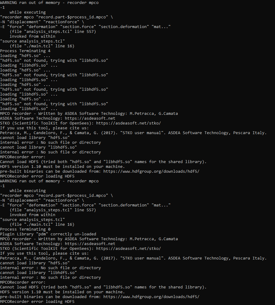

i am trying to do an analysis with openseesMP. I followed the directions in this post viewtopic.php?f=38&t=1642
to transform the analysis from sequential to MP. I get this error though:

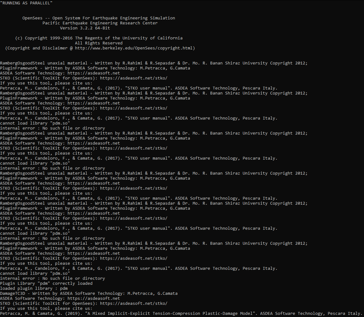

You are receiving this error because you are using DamageTC3D which is not in the public repository of OpenSees. It is built as an external plugin available in the OpenSees version precompiled by prof. Tarque. You can download it here:
At the bottom of that webpage you will find a google drive link that will let you download the installer:
https://drive.google.com/file/d/1ETGQ3Y ... sp=sharing
This is a standard windows 10 installer that will install OpenSees and OpenSeesMP (and all the necessary dependencies) in C:/OpenSees-Solvers and STKO will automatically detect them once installed. Try to use them and see if the error persists.

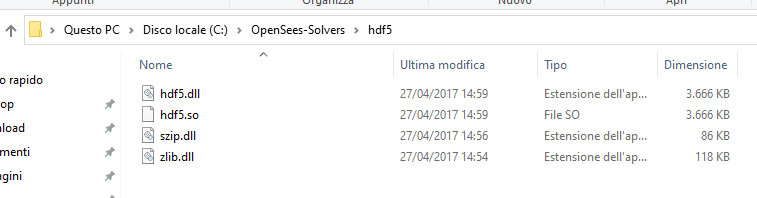

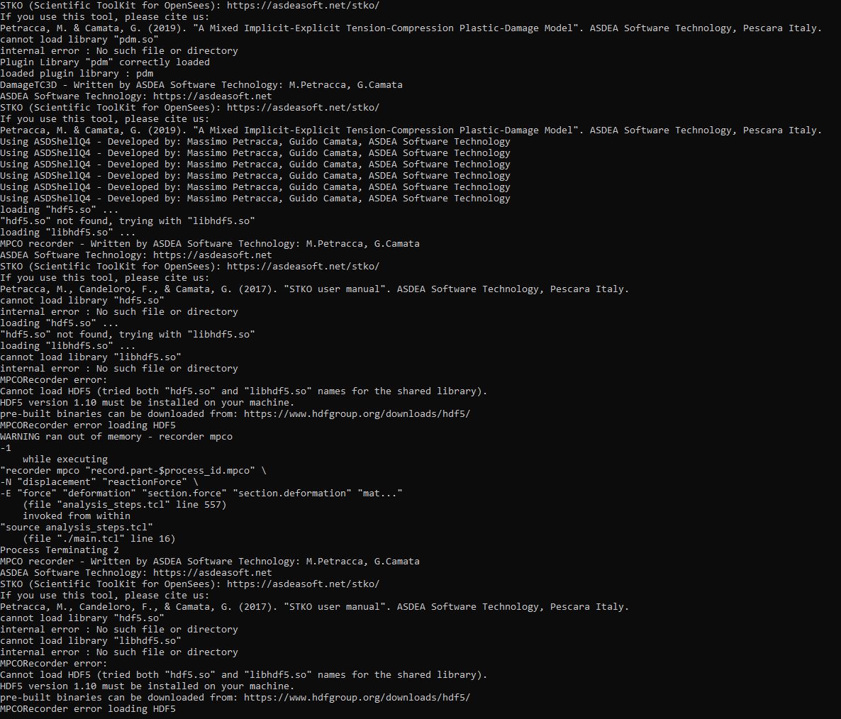

You are having that error because it says that it cannot find HDF5 libraries.
However they are there.

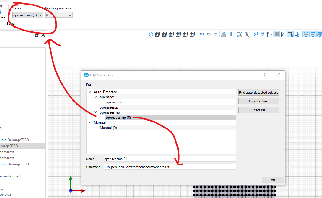

  • First make sure you are selecting the proper openseesmp:
  • Make sure you have the following libraries in C:\OpenSees-Solvers\hdf5:

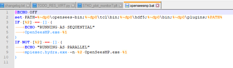

  • Finally, make sure you don't have accidentally changed the contents of the openseesmp.bat file in C:\OpenSees-Solvers:

ok now it works.
hdf5.so was missing.
I reinstalled again the package.
