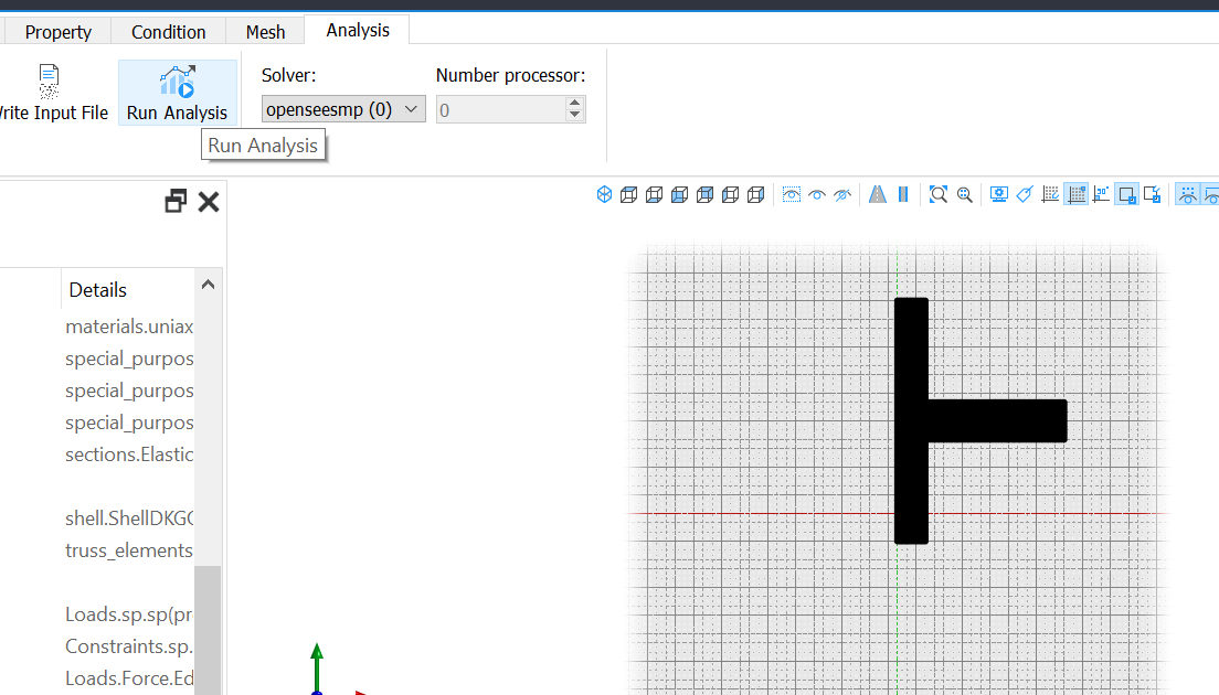

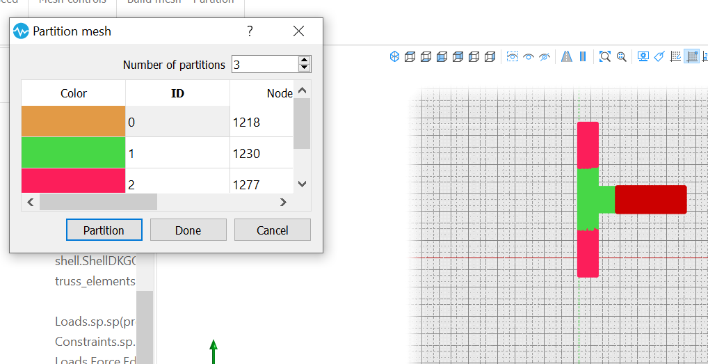

The screenshots of the steps being followed are also attached herewith for ur kind consideration.

- MPpartition.png (91.05 KiB) Viewed 3320 times
- MP.png (37.65 KiB) Viewed 3320 times
- MP,Anlysisi RUn.png (139.35 KiB) Viewed 3320 times
