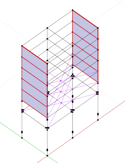

I see. Now, there is another problem I want to ask.
Will the result be weird if I don't refine my mesh for shells(I still use one element per wall)?
Could it influence the result of the analysis if I use a coarse mesh(one element per wall)?
Then, the following is my model. Could you help me to solve the error?
Thank you very much. :D :D :D
Best Regards
Re: Question about elastic shell element
Posted: Wed Oct 14, 2020 8:37 am
As I said in the previous post, it is singular because beams and walls are modelled with separated geometries. Keep in mind that if 2 geometries are separated (and not connected with any kind of kinematic constraint), also the FEM model will be separated, and in your case, the walls are not attached to the beams and so the system is singular since the walls are un-constrained.

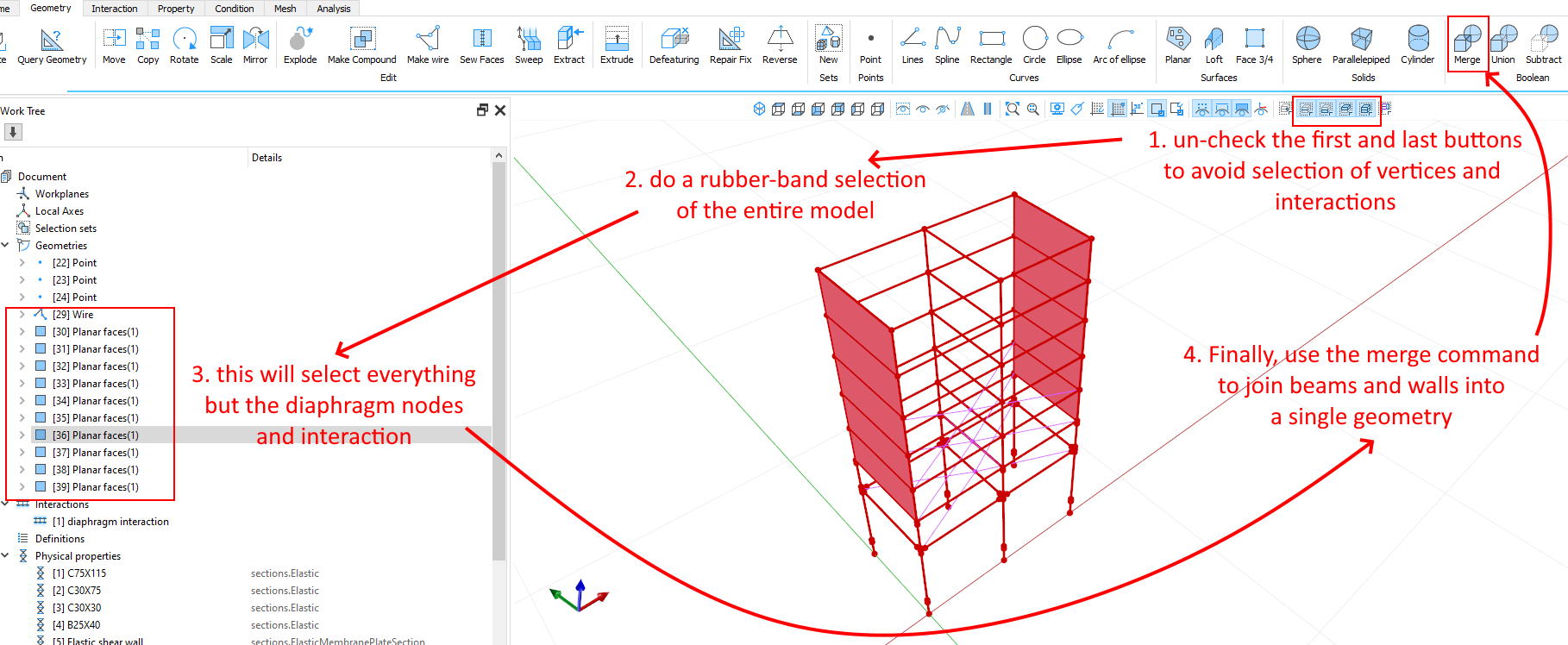

I used the following steps to join walls and beams:
Senza nome.png (248.51 KiB) Viewed 4961 times
After the merge command, make sure all properties are still correctly assinged. In fact, the merge command will join, for example, the edge of the face, and the overlapping beam. Now, only one of them (the beam) has a property. But since the CAD boolean operation uses its own random order, it may happen that the resulting joined edge does not keep the old property assignement.
Note that I also refined the mesh of the wall. To do this, I first used the EdgeSeed command, then I selected all the edges of the walls, and I chose a mesh size = 0.5. Finally press Assign and Done. Finally mesh your model.
