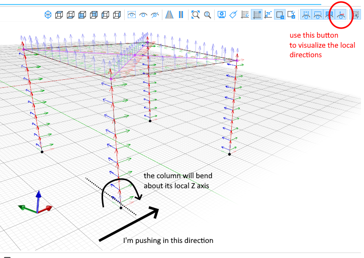

5. For zeroLength element, how to decide which DOF we have to release by assigning a spric material and which one to assign stiff material. ?
It depends on you. In this example I knew my columns will bend only about their local Z axis, that's why I applied the nonlinear spring only at the (local) 6th DOF of the zero length
hinge direction.png (290.26 KiB) Viewed 5169 times
