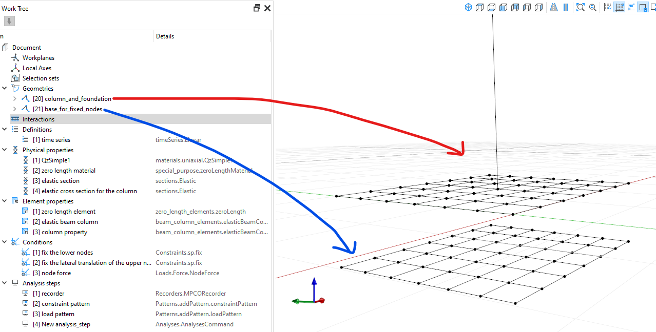

Dear user, attached you can find a modified version of your file.
shallow footing.zip
(112.73 KiB) Downloaded 311 times
The main changes are:
  • I created a copy of the foundation geometry, without any property or element assignment, just to generate base nodes for fix. For the sake of clarity I moved it at a finite distance from the foundation geometry. This will generate a warning because the zeroLength expects a distance = 0 between the 2 nodes. However this does not affect the results.
  • then I merged the column and foundation geometries into a single one.
  • The I created an interaction between foundation and base edges (only EDGES!!)
  • The zeroLength element property in this case should have the "distributed" option checked. This is a STKO feature. In this way, the material property defined per unit length, will be automatically lumped by STKO based on the mesh-size.
  • I also made the beams corotational, so that you can see both p-delta and finite rotation effects.
  • The constraint handler is now Penalty. In this model you will have many kinematic constraints, and the transformation method can fail.
  • Vertical and horizontal load were defined into a single load condition. I split them in 2 coditions, then I applied the vertical load for the first gravity analysis, and the horizontal load after, for the second displacement control horizontal analsyis.
  • I also changed the material parameters for the stiff elastic beam section you used for the foundation. They were 1.0e10, but it gives convergence problems, since this value is too much compared to the real stiffness of your model, and it makes the system ill-conditioned. I used 1.0e6. Keep in mind that 2-3 order of magniture more than the others materials is fine.
