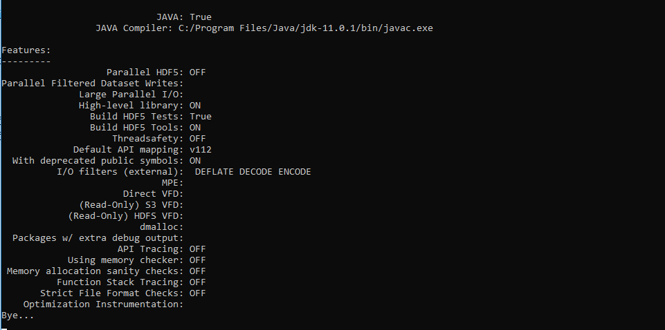

At first, it showed the info in Fig. 1 to let me install the HDF5, so HDF 1.12.0 was installed.
Fig. 1

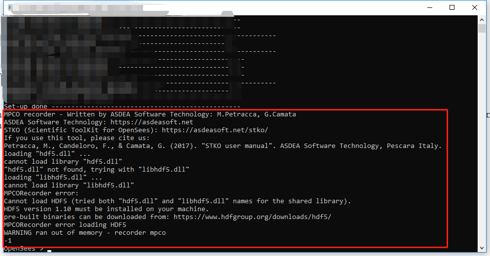

Then I run it again, the outcome in Fig. 2 was got, so could you tell me how to make it right? Thanks.
Fig. 2

Dear user, of course OpenSees needs to be downloaded and installed on your PC, since it is not distributed by ASDEA Software along with STKO.
At the following link you can find a detailed description about how to install OpenSees on your PC:
https://asdeasoft.net/?stko-trial
It looks like you downloaded the precompiled OpenSees.exe 3.2.0 from the official website. In that case you need to install the HDF5 libraries (version 1.10.1, not 1.12.0). Since you have STKO already installed you can do this:
  • Uninstall HDF5 1.12.0
  • go in "C:\Program Files\STKO" and copy "hdf5.dll", "zlib.dll" and "szip.dll" in the same folder where you have OpenSees.exe.
Let us know if it works now
