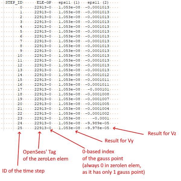

1) there are three options to process the results: 1) "Only Selection Set Elements", 2) "Selection Set Elements + Embedded Elements", 3) "Only Embedded Elements". Can you please clarify what these mean in the context of BeamWithShearHinge? I am assuming I should go with option 3 if I want to get stress/strain at the shear hinge.
2) Assuming that option 3 is correct choice in item 1, there are two columns of results for each coupling beam "eps11 (1) eps11 (2)". What are these referring to? Why eps11?
3) Since I have multiple coupling beams in selection sets there is a number of columns with results corresponding to each coupling beam. How do I know which column corresponds to which coupling beam? I don't see any identifying information in this regard as they are all called "ELE-GP".
Please let me know.
  1. Only Selection Set Elements: Only the elements originally in the STKO's selection set (i.e. the Elastic beams in your case, since the zeroLength elements for hinges are added while writing the Tcl file)
  2. Selection Set Elements + Embedded Elements: As option 1 + all elements found in OpenSees that are fully embedded into elements in Option 1. (for fully embedded I mean that have all nodes shared by elements in the selection set). (i.e. Elastic Beams + zeroLength hinges in your case)
  3. Only Embedded Elements: this is Option 2 - Option 1: i.e. only zeroLength hinges in your case (This is what you want)

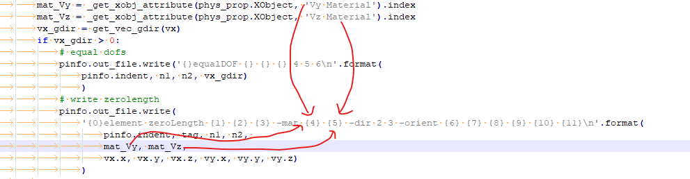

A zeroLength element is a collection of multiple uniaxial materials (2 in your case, the first one is for Vy and the second one is for Vz).
In OpenSees, any uniaxial material that do not handle the "stress" or "strain" in their setResponse, will fall-back to the base-class implementation, that used "eps11" as label for the unique component (see UniaxialMaterial.cpp, line 250):
    // strain
    else if (strcmp(argv[0],"strain") == 0) {
      theOutput.tag("ResponseType", "eps11");
      theResponse =  new MaterialResponse(this, 3, 0.0);
Then STKO appends (1), (2), ... (N) if multiple components with the same label are found (Yes.. I know, element-based setResponse method in OpenSees unfortunately does not follow any rule for the names of the components)
In your specific case of BeamWithShearHinge:
  • eps11(1) (or sigma11(1)): shear displacement (or shear force) given by the uniaxial material Vy
  • eps11(2) (or sigma11(2)): shear displacement (or shear force) given by the uniaxial material Vz
ELE-GP column will give you information about the zeroLength element:
The script could be further improved by adding a new column with a custom name (string) for the ELE-GP combo. This name could be a user-defined function of the X-Y-Z coordinates of the centroid of the element. In this way, based on the coordinates you can identify a name (like beam-first-floor-front-facade)...

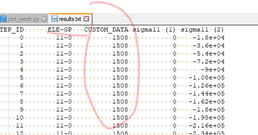

Thank you for the clarification, that makes more sense now. I need to plot maximum coupling beam rotations over the height of the building. To do that, I need to know the location of each coupling beam. Currently, the output gives tag of the zeroLength element, which can be related to the node, which can be related to the Z coordinate. The issue is that information about zeroLength elements is accessible only in elements.tcl, but it is not very easy to extract it as there is a lot of code around it. Is there a way to export all zeroLength element tags with nodes in a table format? Without this, I am not sure how can I create the plots that I am looking for...
Please let me know. Thanks,
Posted: Fri Feb 17, 2023 11:51 am
Try this:
extract_data_from_selection_sets.zip
(4.12 KiB) Downloaded 374 times
Put whatever you want in this custom function:
And you will have an extra column after the ID of the Hinge with your custom name:
Posted: Fri Feb 17, 2023 7:00 pm
by kolozvari
That's perfect. Thank you.
