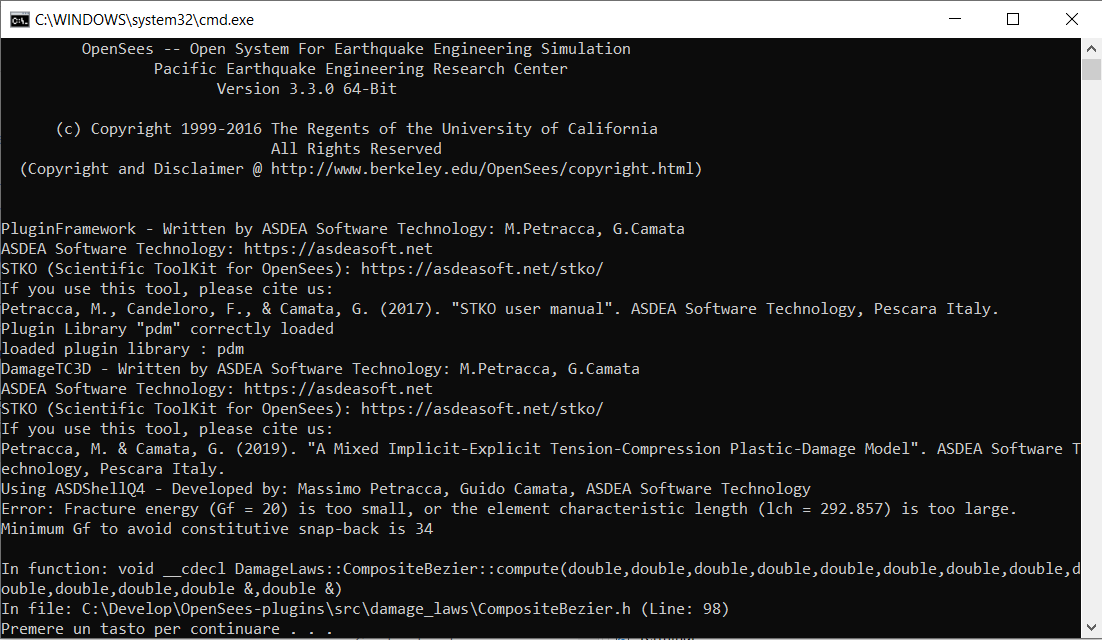

However, this error appears to me .. I don't know how to fix it

It says you need to either increase the fracture energy or decrease the mesh size.
I can't do the material calibration for you. If you want to know how to mesh I did an entire webinar on that.
https://youtu.be/03520sYaKrg
